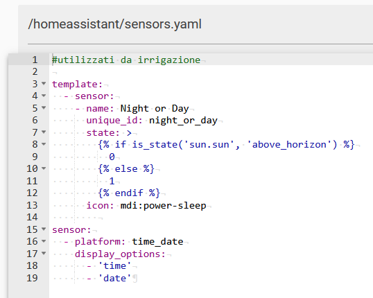

Indentation is ok, but I still get:

isn't this error in configuration.yaml, line 102?

For HA editor, indentation is ok ( i have green check symbol during saving). Do you have latest HA version? night_or_day is in your sensors.yaml or another file?
edit: the problem is:
sensor:
  - platform: time_date
    display_options:
      - 'time'
      - 'date'
if I temporary remove it, I have no error...
here is your problem:
sensor: !include sensors.yaml expects the included file to contain only the sensor list entries (the content that goes under sensor:), not a full YAML document with top-level keys like template: and sensor:.
So either you fix sensors.yaml to look like:
  display_options:
    - 'time'
    - 'date'
and remove the template: block that can't go in there — it's a different top-level key
OR
the easyest fix for you is to move the sensors.yaml file as it is now in packages/sensors.yaml provided in your configuration.yaml you have something like
homeassistant:
  packages: !include_dir_named packages
which you most probably do as you have garden_irrigation :wink:
thank you. I've solved creating a template: !include template.yaml and split my configuration!
