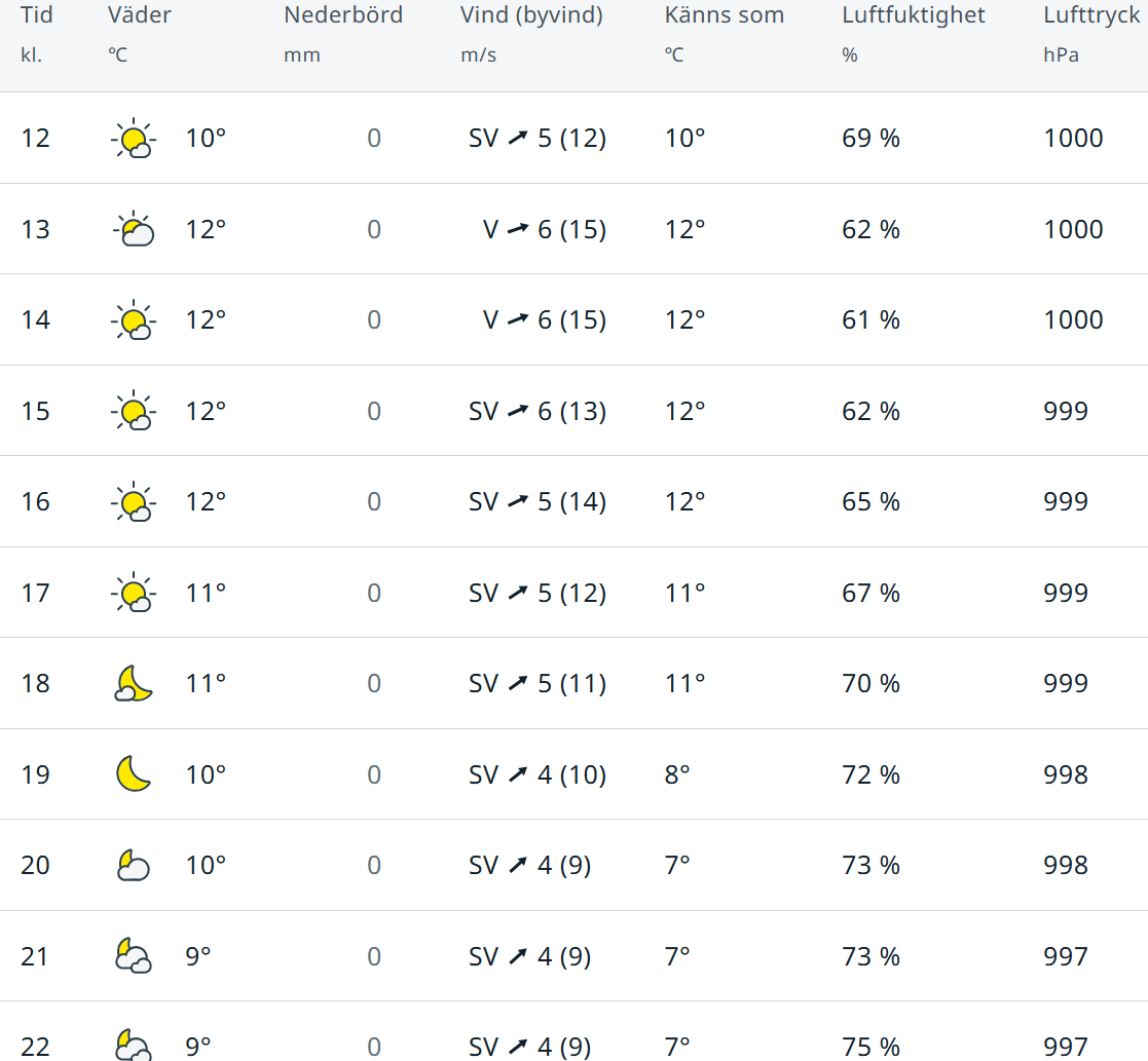

Currently our pressure here is 987 and will go up to 992 by night.
You have your static set to 1013. that is a big difference.
I don’t know where you live, but I just grabbed Londons values:
1013 is a lot more than you typically get in fall.
In summer 1013 is probably a low number.
think about that number 2-3 times.
hint: it shouldn’t be 2 numbers, should it?
