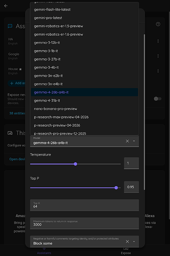

I have been trying Gemma 4, both the E4B and 26B, and both with good result. The 26B a little better. But I had very different experience with the unsloth Gemmas. So I’m using bartowski now.

Qwen3.5/3.6 and Gemma4 are the current king of the local space. Newer models are actually performant at 4b quantization levels. Your chosen model must support tool use and should support ‘reasoning’
