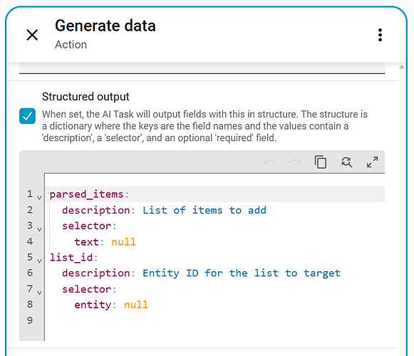

Sure. In a Home Assistant script or automation, you can add a "Generate data" action that invokes an AI Task entity and returns the output. In addition to the prompt telling the AI what to generate, you can toggle on the "Structured Data" setting and include a Home Assistant-style YAML description of what exact output fields you expect.
In this example, the prompt is giving the LLM a spoken list of items and the spoken name of a to-do list, along with a list of all of the possible to-do list entities it might match, and telling the LLM to reformat and clean the item list to a particular standard, and identify the most likely entity match.
Enabling "structured output" on the request engages some mechanisms on the server that coerce the model into only outputting syntactically-sound results, e.g. only valid JSON (I think llama.cpp's implementation is called GBNF?) Most likely the model itself is generating JSON and Home Assistant is just translating it to/from YAML. But the result is that the data returned to Home Assistant from the "Generate data" task is a variable with typed keys and values that you can use just like any other automation variable.
