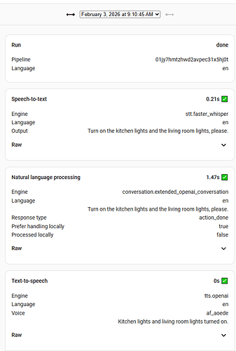

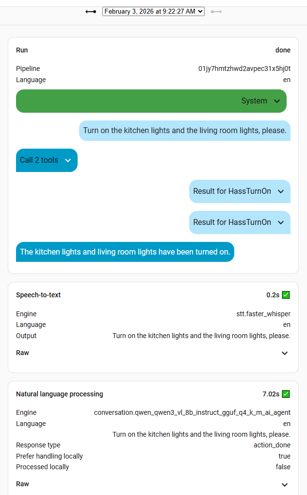

Just to come back and touch on this, I’ve gotten everything updated (llama.cpp, tried both HACS integrations and the extended_openai_conversation is so much faster for me…though the “hass local openai” one no longer takes 25+ seconds but it’s nowhere near as fast still).
Here are my tests from earlier:
extended openai
hass local openai
While the second screenshot looks entirely different than the first, I can assure you they both completed the tasks successfully.
EDIT: Just to add, I asked the same command of each integration three times before taking a screenshot just to be sure everything was fully and completely loaded. Screenshots came from each after the third time.

So why did I have to do it again? Well, because I could see there was a massive token discrepancy from one to the other. I wanted to see what exactly was getting passed so I had to enable “verbose logging” within llama-server and do the whole thing again.
If you’re interested in looking at the nearly 4k lines produced by Hass Local let me know. I also have the corresponding log file for Extended OpenAI which is just a little over 1200 lines. I’d upload them here but it won’t allow me to and I don’t want to take the time to upload them elsewhere and share the link here unless someone feels it’s worth looking at.
Suffice it to say though, I’ll be sticking with Extended OpenAI for the time being.

Each of my posted logs are the result of one single voice command, there is no “follow up” so to speak. The flow was:
  1. Fresh install of each integration
  2. Configure voice assistant to use the integration
  3. Ask “turn off the hallway and ktichen lights”
  4. Ask “turn off the hallway and ktichen lights”
  5. Ask “turn off the hallway and ktichen lights”
  6. Grab only the logs for the step 5, all previous logs are not present
So each integration was using a “warmed up” instance so to speak. Just simply saying “turn off the hallway and kitchen lights” results in two separate sets of “prompt eval time” results in the log.
You can see what I mean by looking at the timestamp for either, but this is the “extended openai conversation” logs…those two separate “prompt eval times” appear in the same second:
Those aren’t from two separate requests, that’s just me saying “turn off the hallway and kitchen lights”
There were two times before anything shown in those logs where I asked it the same thing to make sure the model was loaded and warmed up. For “extended openai conversation” the first request takes about 3.5 seconds, subsequent runs are less than 1.5 seconds. What you see in that log is the result of only the third request.
That goes for the “hass local openai” integration as well, just with much longer times.
