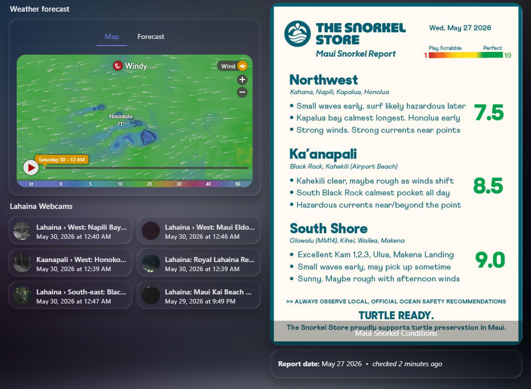

My Maui at-a-glance ocean dashboard: West Maui beach cams, weather, and the daily snorkel report
Living on Maui, the questions every morning are the same: how's the surf, is it windy, and is it a good day to get in the water? So I built a single dashboard that answers all three at a glance.
What's on it:
  • West Maui beach cams — live looks at the actual conditions, because nothing beats seeing the water.
  • Weather via the Windy integration — wind, conditions, the stuff that actually decides whether you're swimming or watching.
  • The daily Maui snorkel report — a local shop posts a conditions/visibility report every morning, and I pull it straight into HA (more on that below, it was the fun part).

Then a Generic Camera points at {{ states('sensor.maui_snorkel_report_url') }} and it shows the current report on the dashboard. It walks back up to 10 days, so it handles the daily publish lag and any skipped days automatically. (Uses wget because the HA Core container ships BusyBox wget, not curl.)
