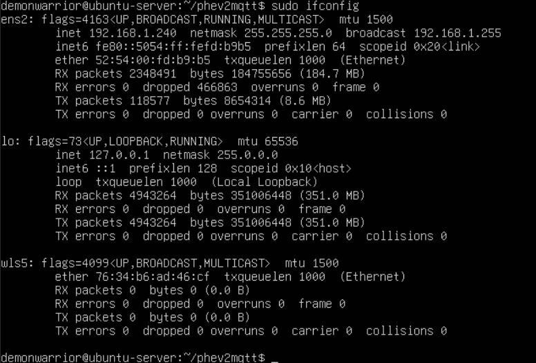

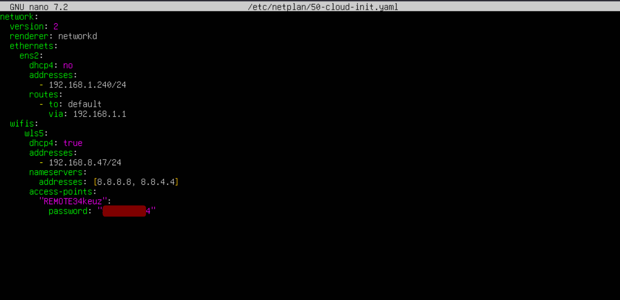

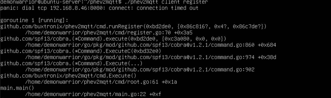

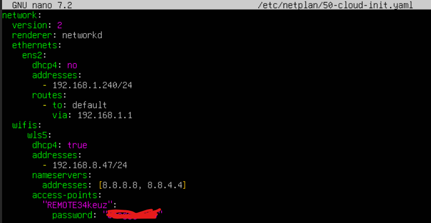

So question. I have a 2018 Mitsubishi Outlander PHEV. I setup a vm on my unraid with ubuntu server 24.04 did all the install steps, but im a bit confused on how to link it. i have already setup the mitsubishi motors app called Remote Ctrl and i got the ssid: REMOTE34keuz and my password: mysetpassword. Inside my network config i have a static ip for my lan cable and a 2.4ghz wifi card installed passthroughed the vm with the ssid of the car and my password for the car ap. But everytime i run the script it cant verify. i keep getting a waiting after running the command
Am i doing something wrong before i run this command though in my vm on my network. I do the following to put it in pairing mode
  1. opening the drivers side door closing it
  2. closing the door.
  3. turning the car in accesary
  4. press lock and unlock alternating x5 each a total of 10 until i hear the beep once for 1 device connected ie my phone
  5. then start the command on ubuntu to register
    am i doing any steps wrong any guidence would be greatly appreciated im link losing my mind trying to get this to work
    Network configuration

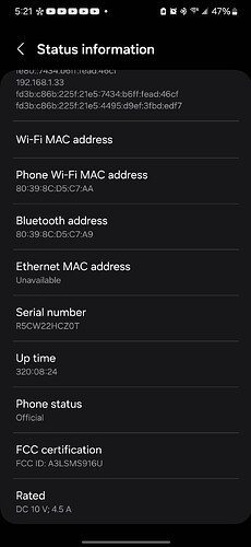

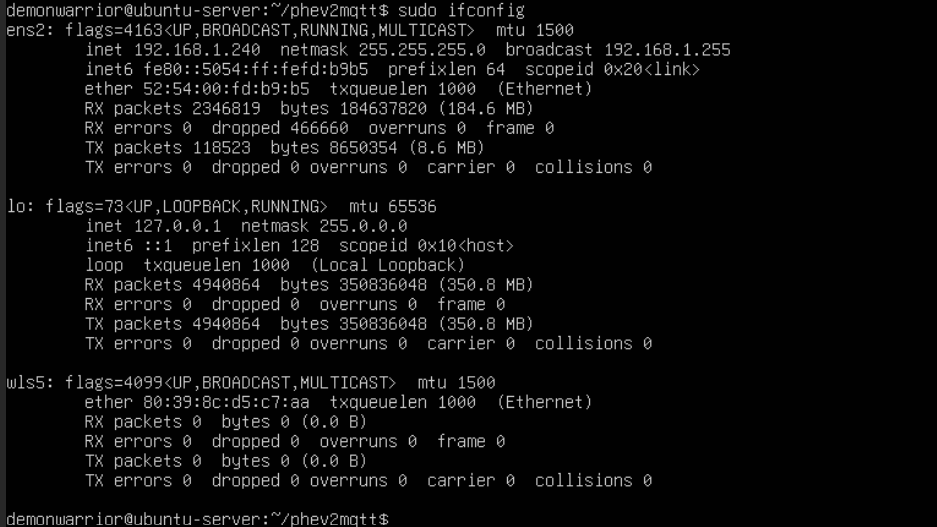

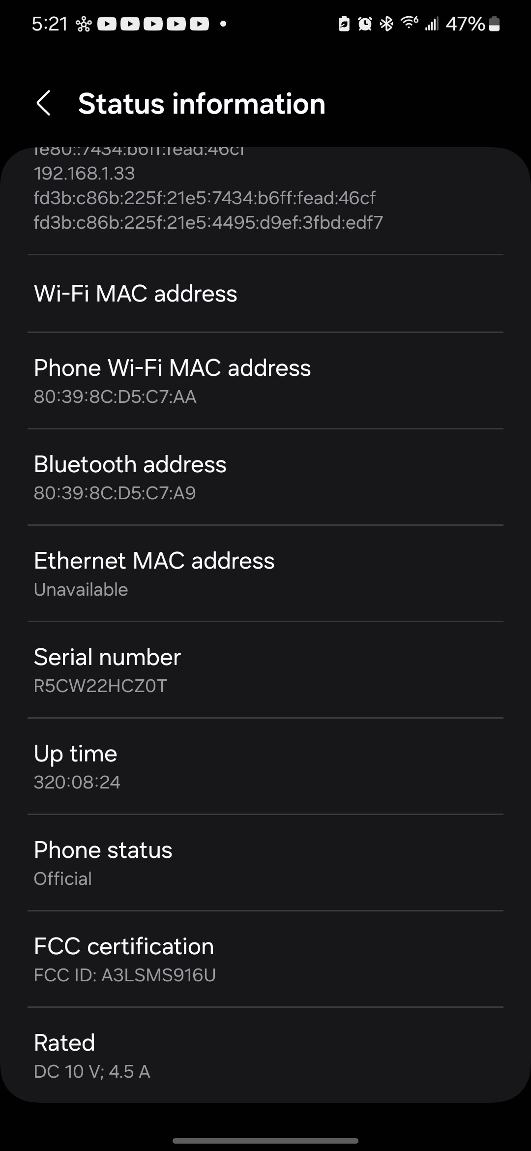

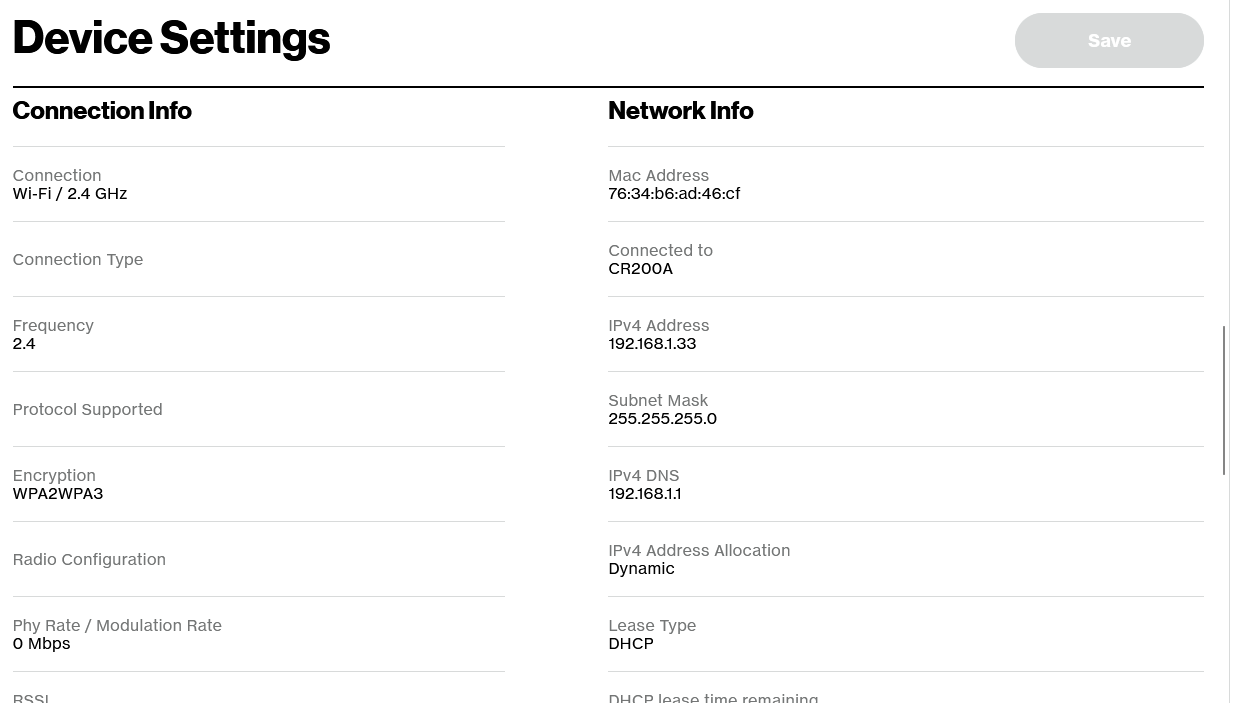

I reset my cars connection and then i paired my phone. Use same mac-adress on your wifi and then it works with the same ip assigned, 192.168.8.47. Didnt get a separate connection working.
So I tried my wifis Mac address for my phone and the Mac address in my phone’s settings and no luck for either. Is something wrong with my setup of the wifi networking. It keeps saying connection times out.

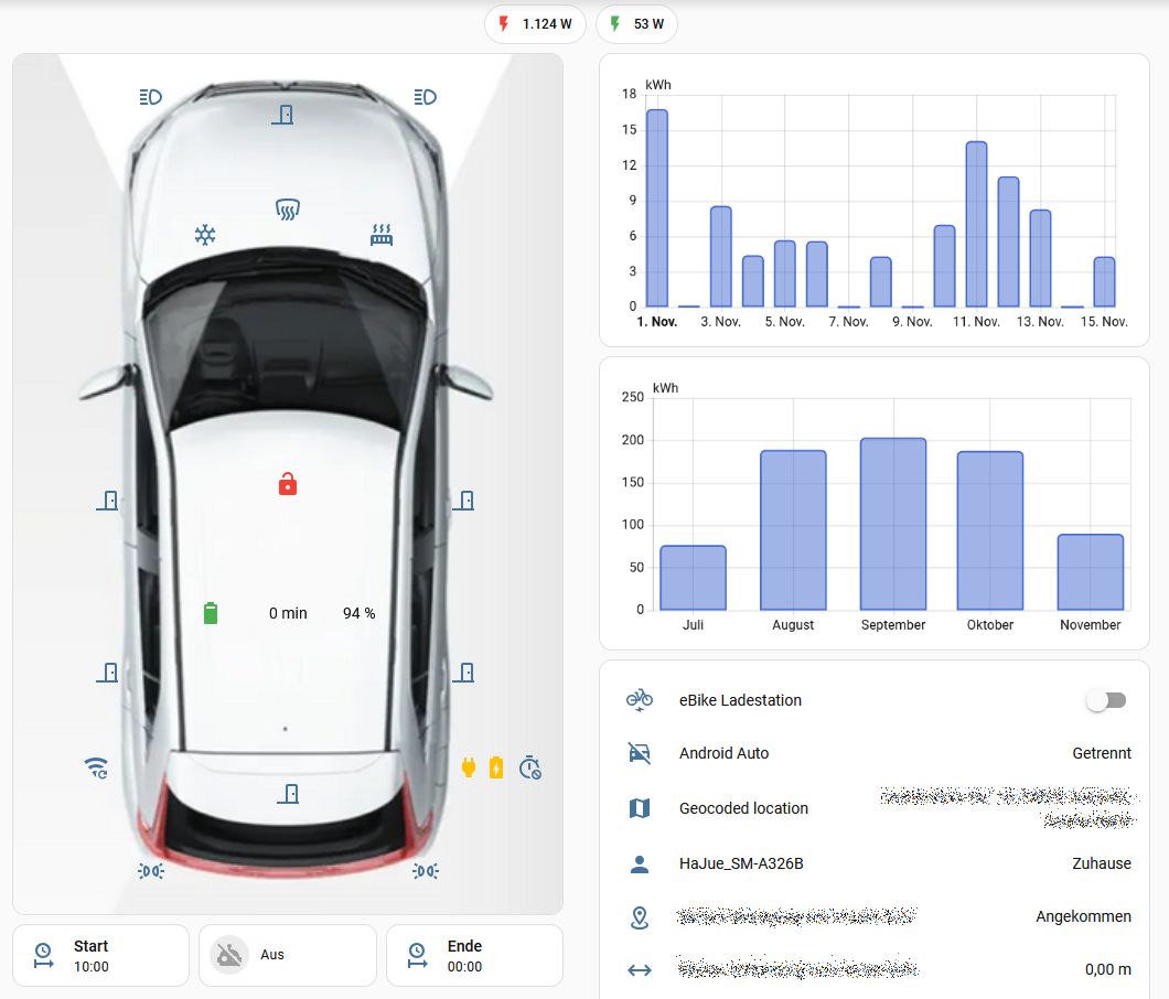

This is the best project in Home Assistant in years! I was so disappointed with the “remote control” for my 2024 Eclipse Cross until I came across this post. Thank you so much for this!

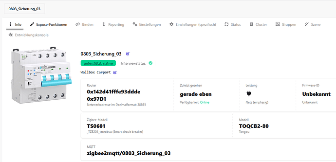

One question: Is it possible to set cancelchargetimer on to stop charging?
It seems that it is only possible to set it to off for start charging.
Thanks.

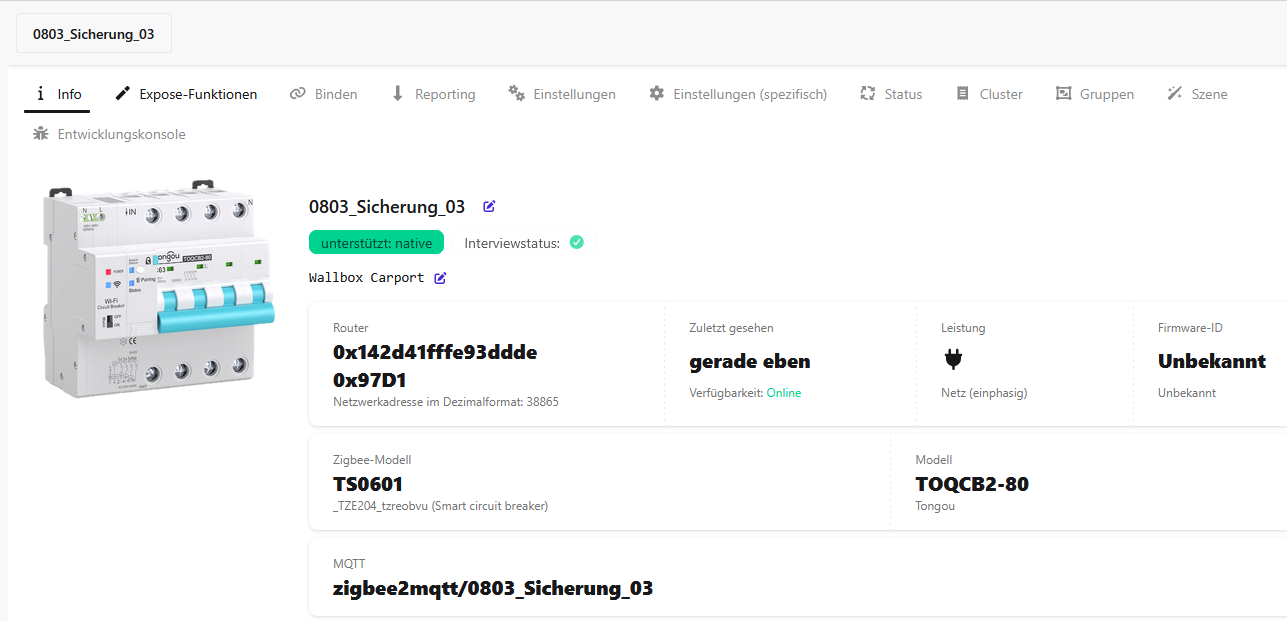

I solved the same problem by using a smart circuit breaker (Zigbee with electricity meter, but this is only for electricians!).
