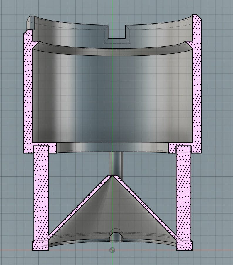

What helped even more was a speaker “cabinet” I 3D printed and stuffed with polyfill. The result gives a more more faithful tone from it, and disperses it around the room. 3D printed needed and some design skills if you want to change, but about $3 in filament give or take.

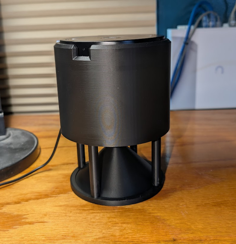

The design looks like this (cross section). The speaker goes into the larger chamber facing down. Down-facing also works best with the noise cancellation built into the reSpeaker. The speaker goes on top of that top ring (and save the shipping circular foam to get a bit of padding under it). The cutouts are for USB connector and mute button. In the side view shot you can get the idea. The cutout showing here on the front doesn’t have a USB plug as that reSpeaker is modified, but the normal ones come with a USB on front and back (as seen from the edge), one for the mic array, one for the ESP32.
This mounting exposes the top light ring which gives useful feedback on progress – it points to the source of voice (indicating its “beam forming” for noise cancellation in other directions is working), and it has various indicators of thinking and responses, and failure modes. A right angle USB C works nicely to power it.

The case is in Fusion if anyone wants the model (and I can figure out how to attach it here) you are welcome. It’s fully parameterized so with some measurements you could redesign for a different speaker (well, smaller, if you go much better you need to change how it holds the puck). On a P1S it’s about a 4-5 hour print with PLA and standard quality.

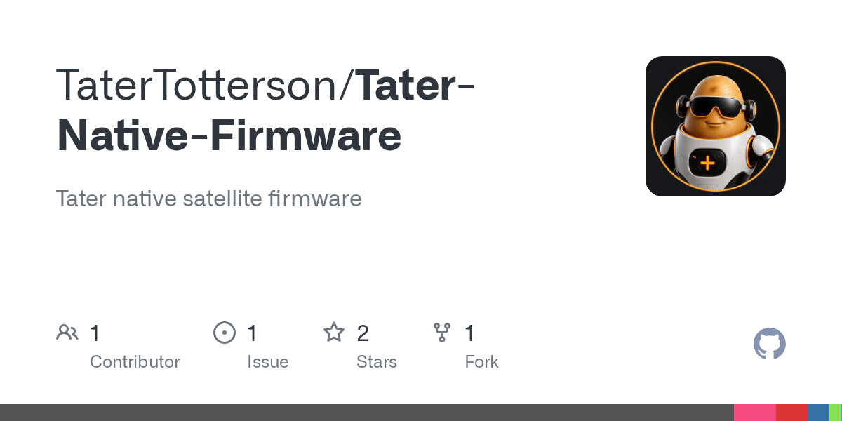

yeah formatBCE’s is basically the same, only difference is it uses ESPHome and its Home Assistant API. Tater is native ESP-IDF firmware with its own wake, audio, OTA, provisioning, and Tater/Home Assistant protocol. The microphone front end is broadly the same

how is the sound on the enclosure you made?
I’m really quite happy with it. The VPE in comparison is crap in terms of sound. It’s not home theater quality of course, but mono music played over it does not make me cringe. I’d say it is roughly on par with the Google Home (not the mini, the middle size one, if they even still sell them).
The speaker itself lying on the table was rather tinny – still probably better than the VPE, but not great. Put it inside a box like this and it’s much better. Much. I tried various sizes and spacing and filler and it seems more about getting a semi-air-tight box around it rather than specific size. And I do think the cone helps disperse the sound, though variations on angle and height also did not change much (my poor P1S printer cringes when I go into the room, I think).
But for a bit of filament and a $15 speaker, well worth it.
