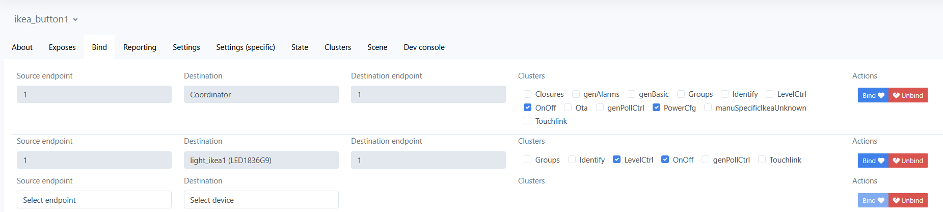

See if your SNZP-01P has not bound itself to the Aqara plugs, or vice versa.
