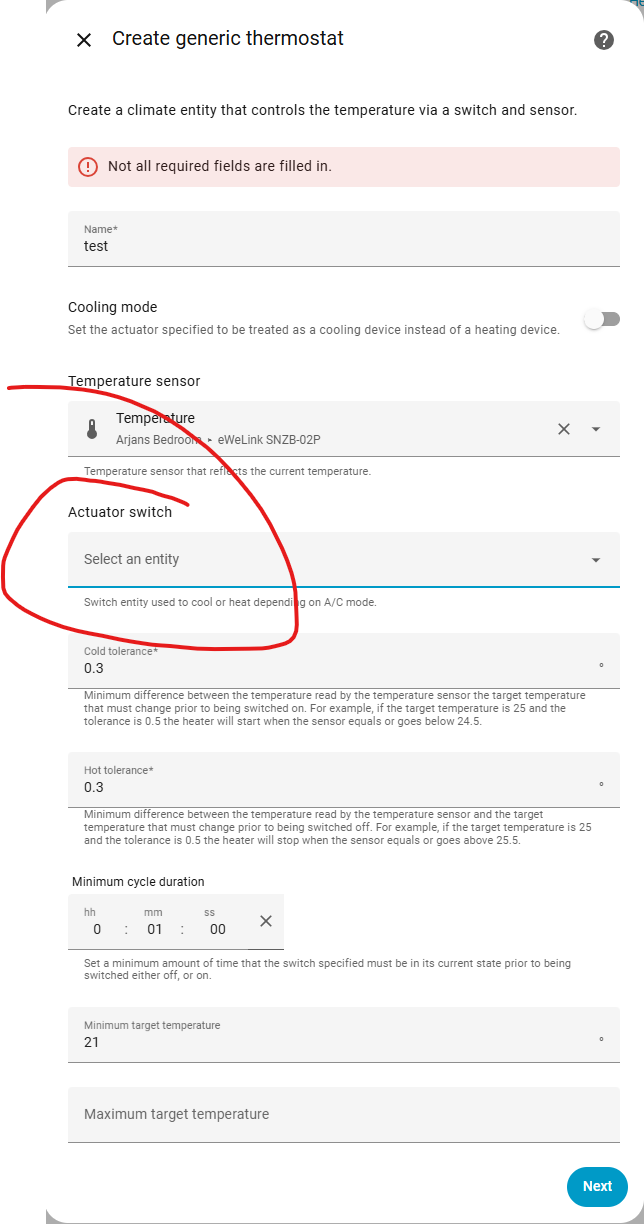

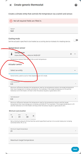

Hi, thanks for replying :slight_smile:
I was looking at the generic thermostat but it looks like it needs to be hooked up with actuator switch for heating / cooling. I agree this does look far better and on the forums this seems to be the best way forward. If you can help me on getting around this i am happy to use it.
I only need HA to message me if the temp is outside of the tolerances so i dont want to trigger any actuator actions
Just use a helper for that. I did it for my thermostats as they do not “switch” anything but i control an OT device for that (and that doesnt even switch, just tells setpoints)
Settings → Devices and Services → Helpers → Create Helper → Toggle
