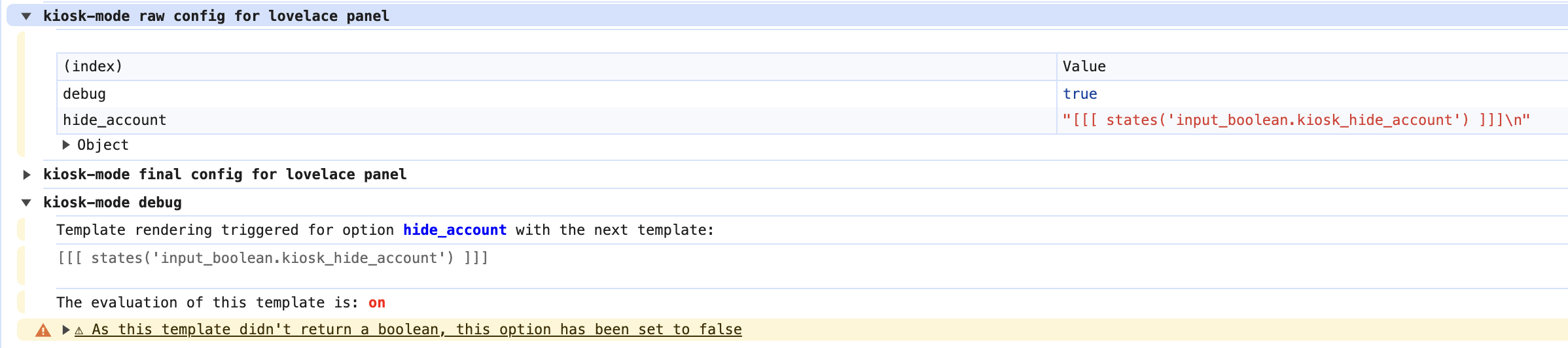

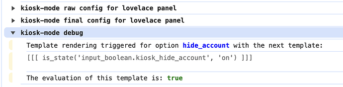

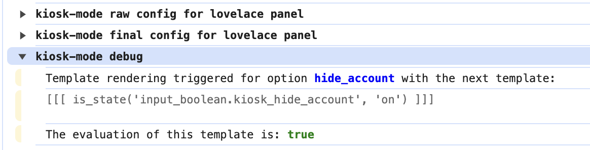

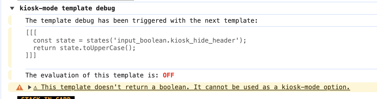

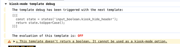

3. New debug options
This release brings two new options:
Config Option Description
debug Prints useful information in the console. The raw config loaded from the Lovelace panel, the resulting final config with all the options, and if a template is rendered, it will print the option that trigerred the template, the template code and the evaluated result of it.
debug_template Useful to debug the result of a single template without activating the debug mode.
debug
Example with a valid template
Example with an invalid template
debug_template
