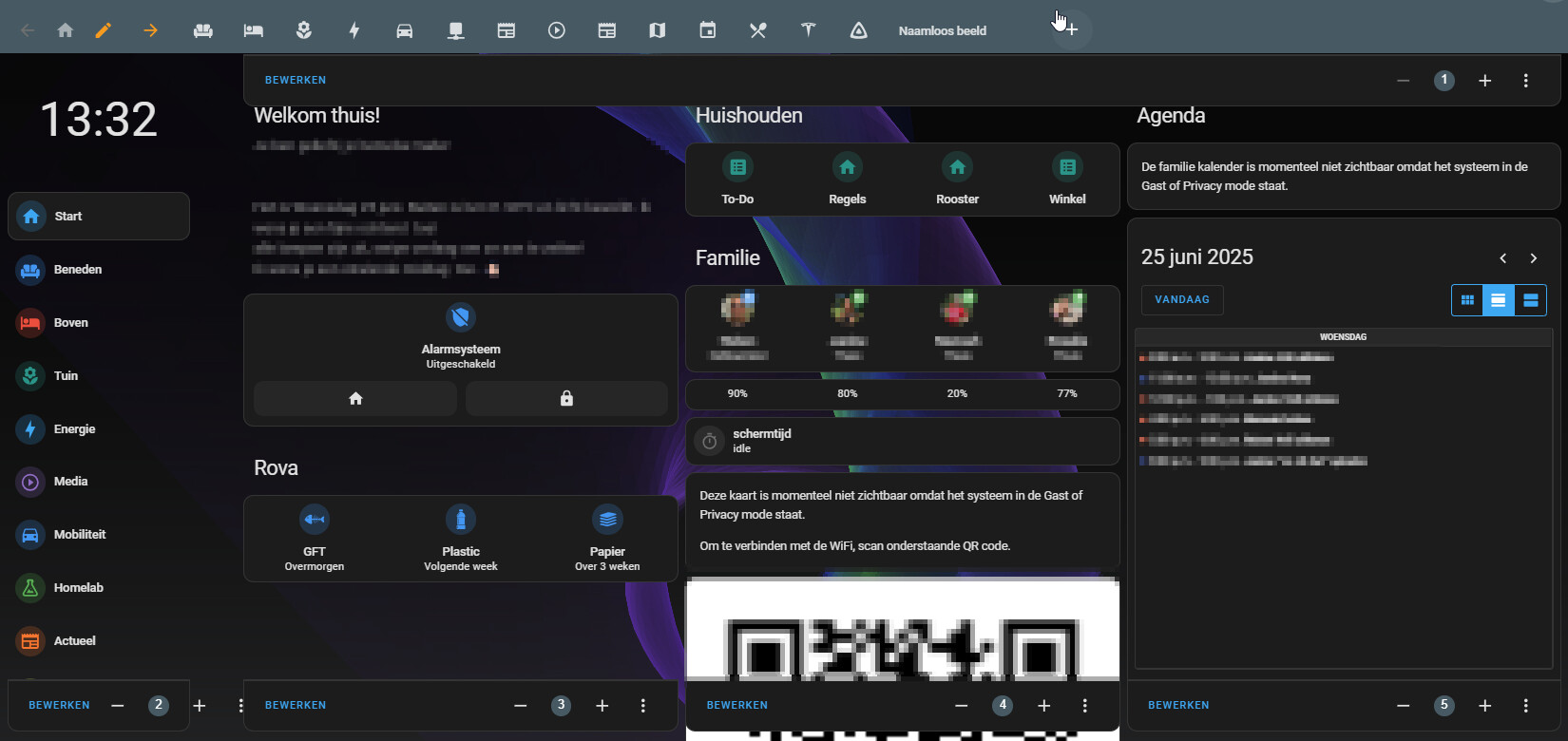

My take on a wallmounted tablet dashoard
Hi, I wanted to contribute back to this community by sharing a few screenshots of my kiosk dashboard running on a Amazon Fire and maybe inspire some other users looking to build a dashboard. It’s build in the mushroom theme with a lot customized cards and pop-up cards (the majority of the cards) to declutter the interface. If requested i can share the yaml files

Are the icons on the left the built in sidebar, or did you add those to a dashboard and hide the sidebar?
I started with the Grid layout on a tab with this code:
grid-template-columns: 12% 3% 28% 28% 28%
grid-template-rows: 32px 770px 200px
grid-template-areas: |
  "menu . top top top"
  "menu . col1 col2 col3"
  "col4 col4 col4 col4 col4"
after that i ‘assigned’ the vertical-stack card to the menu section and just linked every new button to a new tab in the interface, to highlight it i used card_mod to hide the background in whole, except the selected section (start in this case)

after that is a matter of copy/paste it in every tab and ajust the highlighting of the chosen tab
I’m excited to dig in and work on my own variant of this. Thanks for following up with your code!
I’m also curious about your theme. Is that custom or do you use one from HACS? If it’s custom, are you willing to share the source of the backgrounds? Looks so nice!
I have been trying to get this working and have been struggling.
Would you be willing to paste the entire dashboard yml? I’ve tried it a bunch of ways and can’t keep the elements from overlapping.
