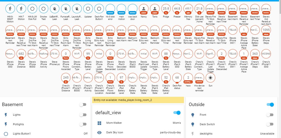

Hi all. I was reasonably happy with my layout both the Web interface and the mobile app.
Since the last upgrade that deprecated view and control from groups, it’s a hideous mess. I used to have items in the default view group show up at the top. Now, my groups are all still there, but there are 100s of entities at the top of the page. Even things that I don’t want to see ever are showing up (media player stuff etc.) And there are groups I didn’t configure showing up. And groups like group.all_lights that are set to hidden in customize.yaml are appearing.
So, I need to fix this. What’s the best way to go about it? I’ve never done any Lovelace config, should I scrap groups and custom configure Lovelace? Are there any guides to configuring the look and feel?
Also, I really want to get rid of, and never see again a bunch of entities. ANY media player. TV, Amazon Echo, Roku, Sonos. Just a personal preference, I don’t want them in HA. I have them set to ignore in the discovery section, but they insist on showing up.
