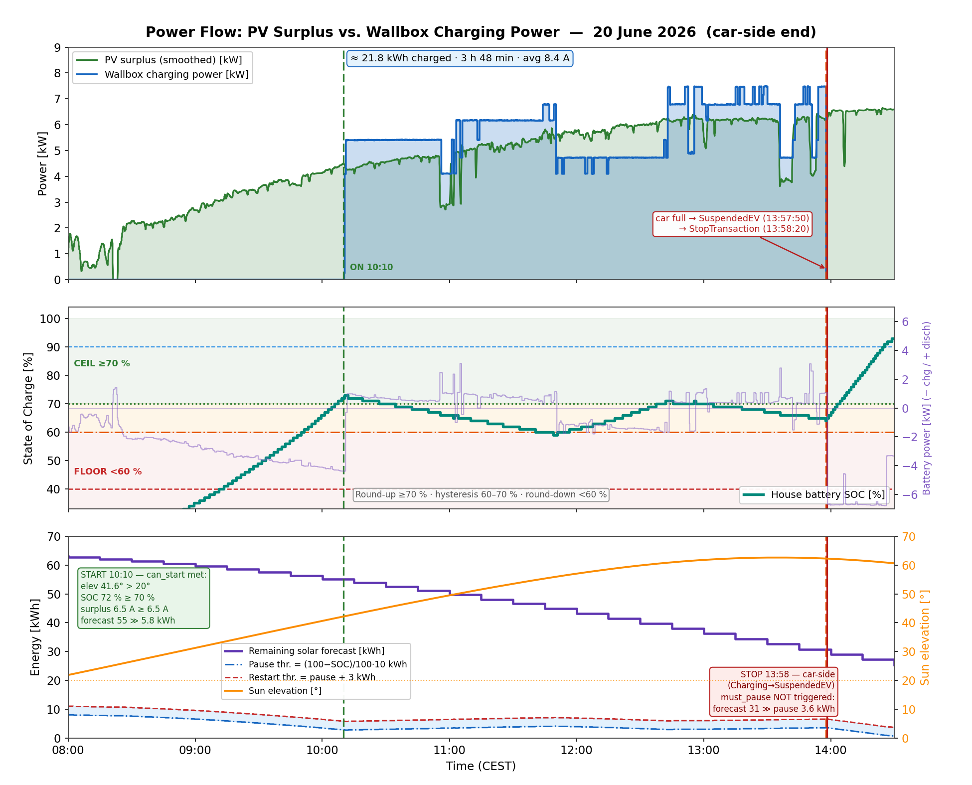

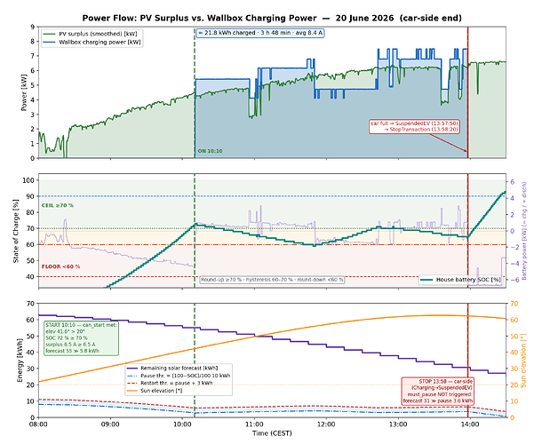

Here are 2 graphs to show the charging behaviour during 2 days.
Car plugged in during the night, surplus automation switched on. Waiting for conditions are good enough to start charging at 10:10h. As car was fully loaded, automation and Charge Control switched off.
Automation stopped car charging when remaining solar forecast wasn’t sufficient to refill house battery for the night.

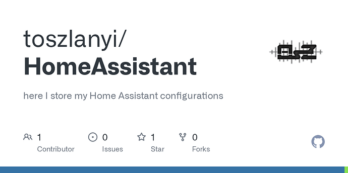

For all the details: I store my whole HA configuration on github as well.

Edit / PS: as the header of the automation file directs to use it with ebox.py override → here the link My working Compleo (innogy) eBox Smart override · lbbrhzn/ocpp · Discussion #2029 · GitHub
I have implemented the soft ramp up and zero load contactor opening (hardware longevity for my eBox) patch into the ocpp integration, so also manual charge sessions will benefit from that design decision.

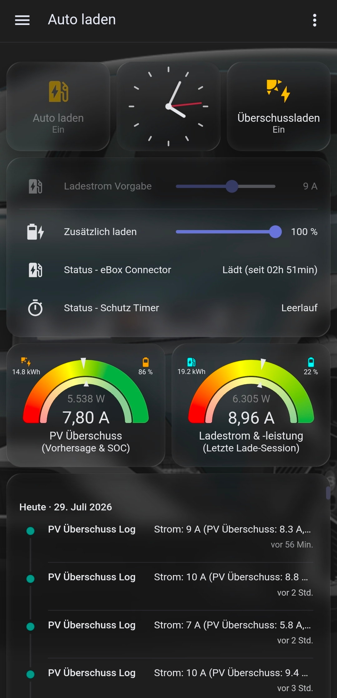

And by the way… This is my car charging dashboard. While the solar surplus button is active, the charge control switch and target current slider are greyed out and don’t react on (accidently) clicking / pushing. Realised that with card-mod integration.
Cheers!
