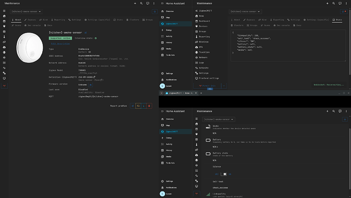

  1. Another issue is that I have managed to connect my Moes ZSS-HM-SSD01 (smoke sensor). I have also tried it by doing a self-check smoke alarm where I could clearly hear a beeping sound from the sensor. I have also waited more than 24h to make sure that maybe some exposed data will come after some time. But this sensor shows only silence and linkqualty. All other settings are null, and it looks like I cannot trigger them (or this is expected behavior, and I need to try with real smoke)? The interview of my sensor is reported as SUCCESSFUL. Below you can find some screenshot:
I do not know if there is something I am doing wrong or if my antenna or sensor is broken? Maybe you can help and let me know if I can test it somehow, or perhaps you see I have done something wrong and you can tell me what I can fix. Below I also share my docker-compose.yaml and zigbee2mqtt.yaml config files. If you need any logs from me or i should try to perform some operations, please let me know in the comments, and I will provide everything you need.
