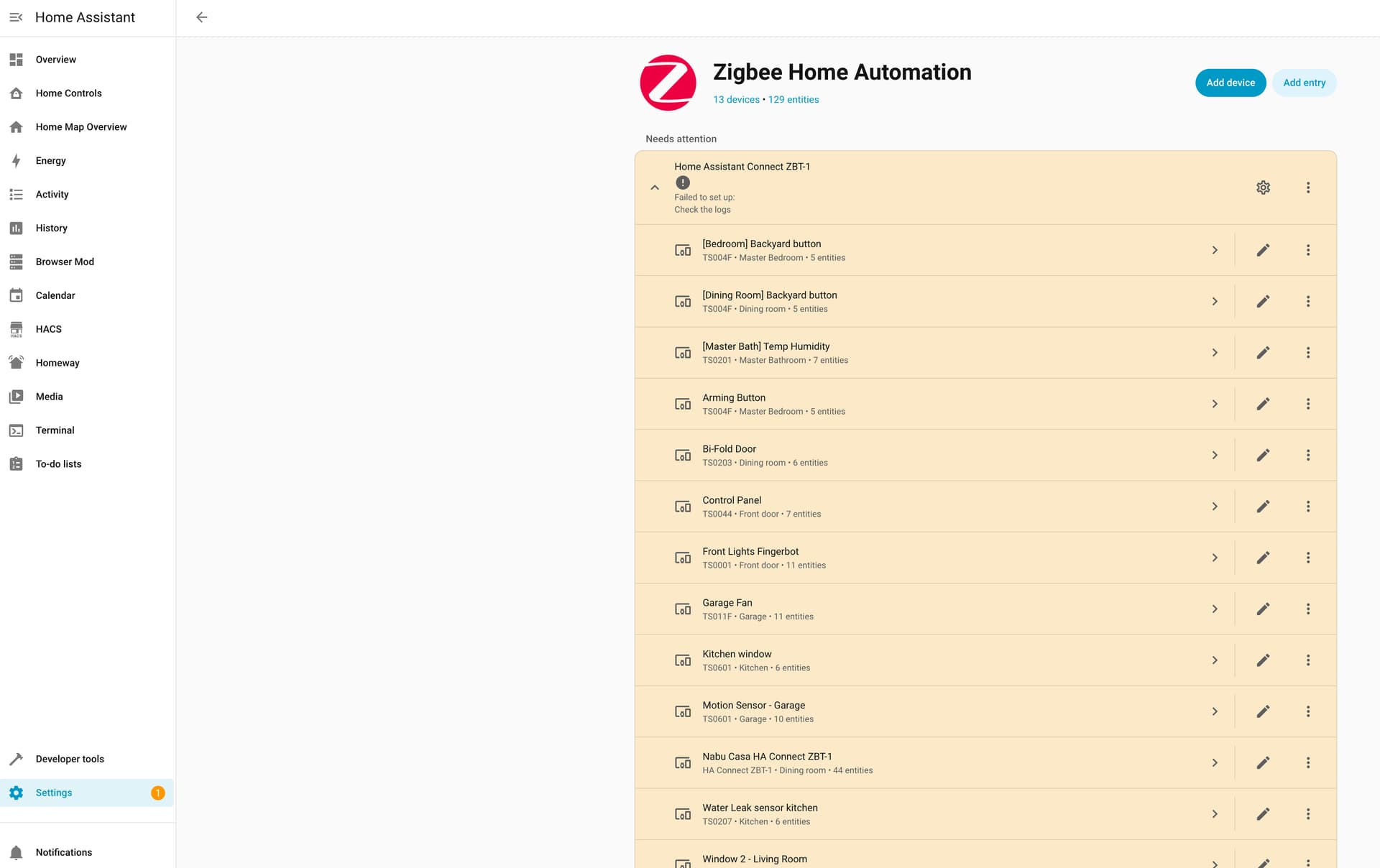

My zigbee device is not connecting + all my automations are gone
New user here, and have used HA for about 4-5 months without any issue after setting it up. But now, all my automations are gone as well.

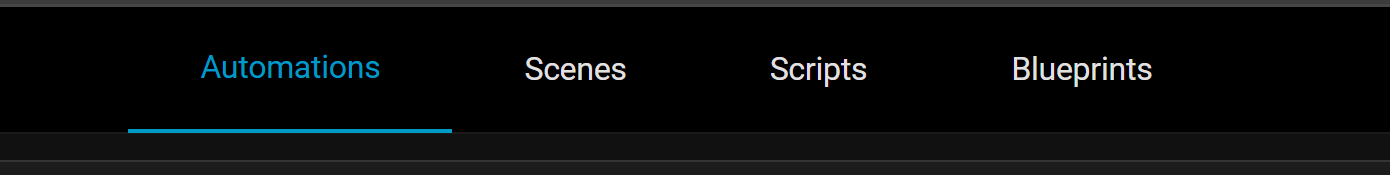

When you select the Automations Dashboard do you still see the automations?
Most likely the Automations are still there, but the errors occur because the associated devices are not currently present in HA.

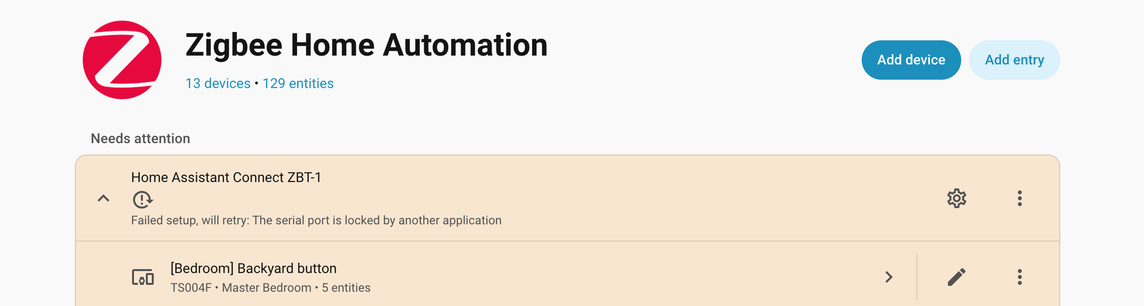

Shows a new error with Zigbee - that the port is being used by another application, not sure what that means?
I don’t see any of the automations. I am hoping if I fix the zigbee issue, it’ll all come back, but I am not able to fix the zigbee issue yet.
I have the exact same problem with my Skyconnect dongle. Made an HA core update to 2025.10.2, since then, ZHA won’t initialize and the automation tab is gone. Rolling back to 2025.10.1 didn’t work either.
