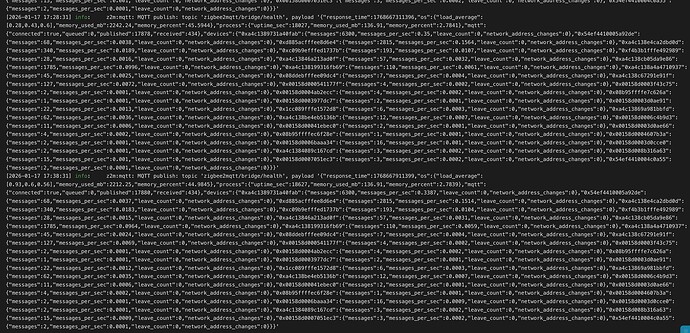

Checking the add-on blocks, this is all that I see, repeated over and over. (Screenshot attached)

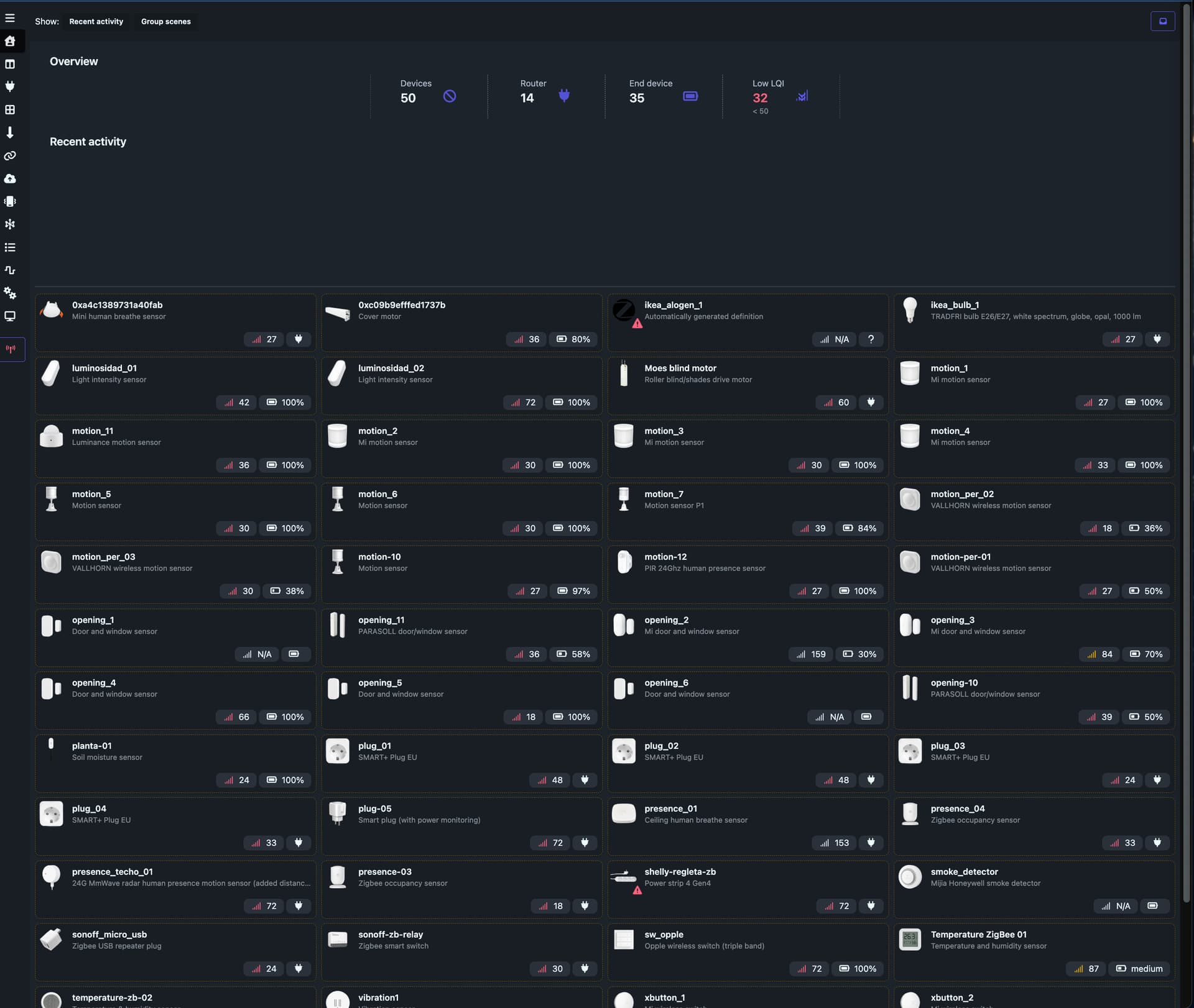

This is how my zb2mqtt looks like, nothing out fo the ordinary:

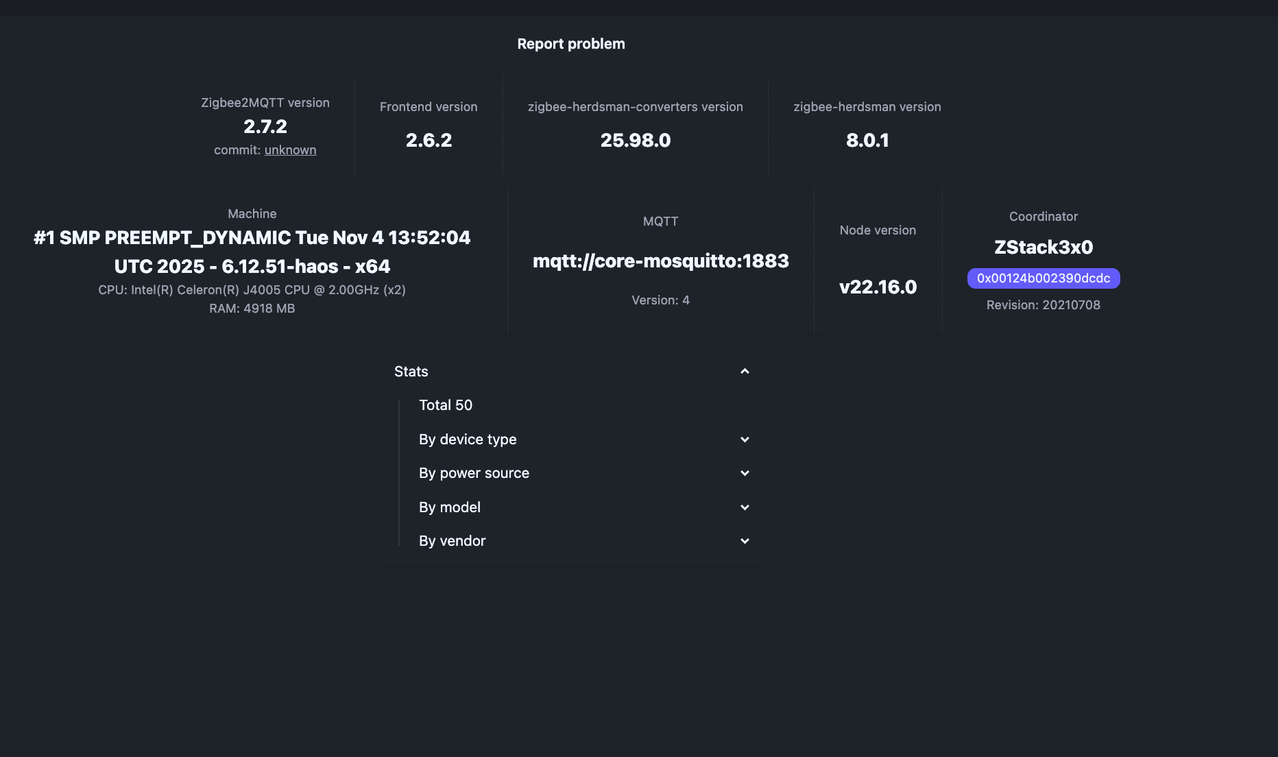

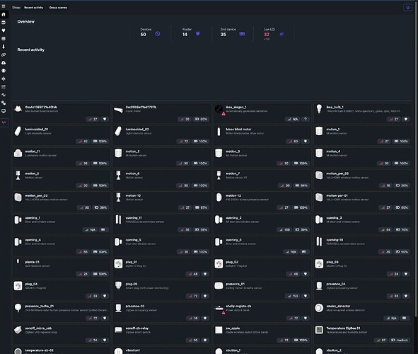

This is my about section of zb2mqtt:

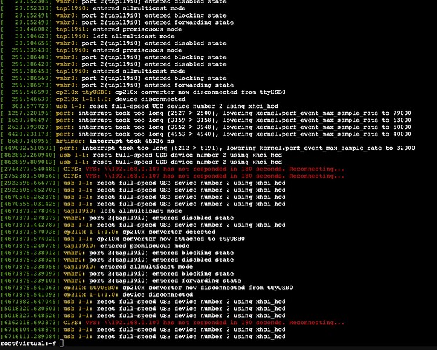

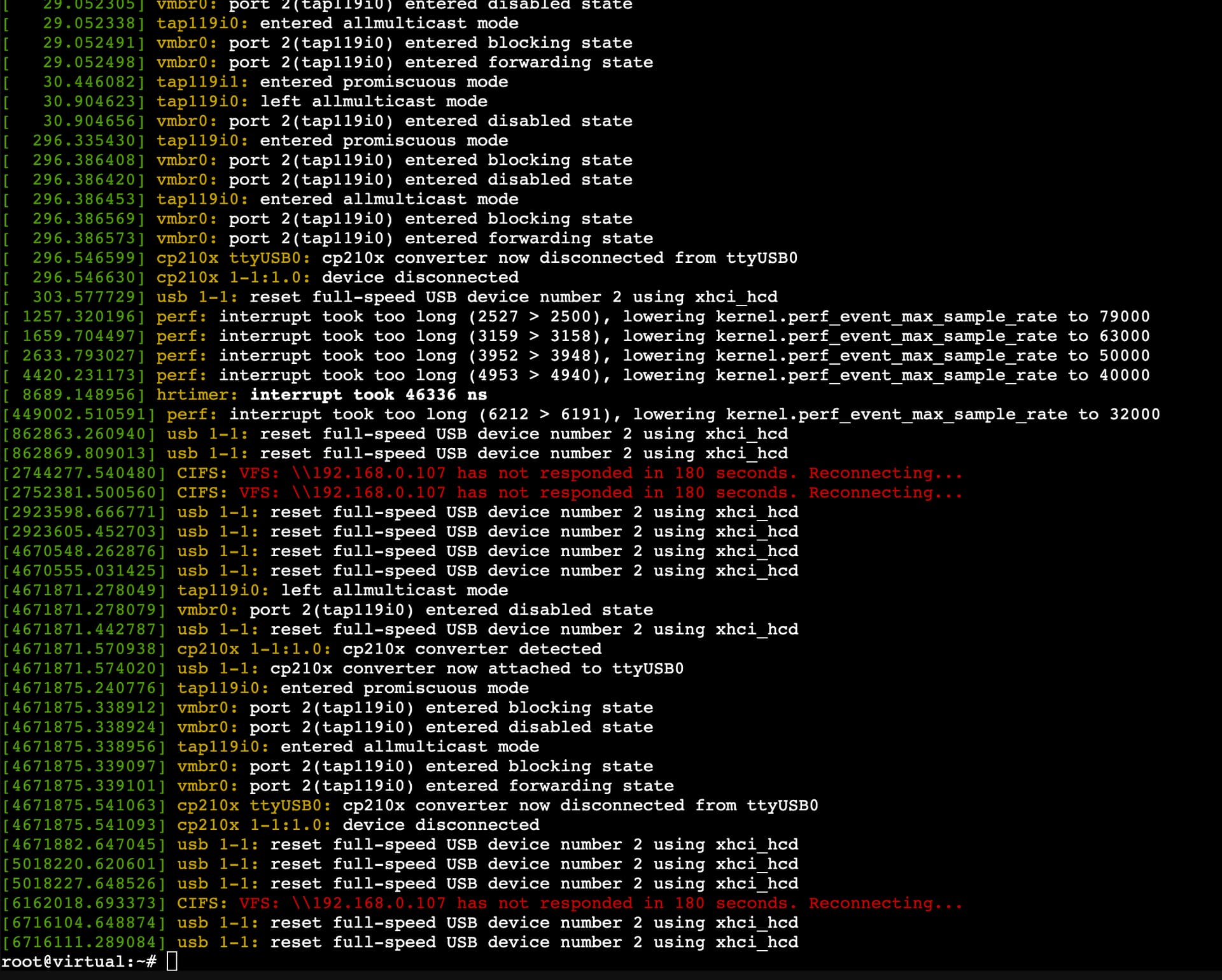

checking dmesg in the host machine of the virtual VM where HA is running I see the following:
Try unplugging then replugging the coordinator. 14 routers vs 35 end devices might be a little on the low side router wise?
Really? I already have like 4 useless zigbee plugs just to have some more routers around the house. Do I need to have the same number of routes as end devices? 14 is almost half 35 so I think it is a safe ratio, no?

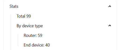

It doesn’t hurt to try more routers. There is no set number or ratio, but if you already have routers that you can join the network I’d definitely look into that. My network for comparison:

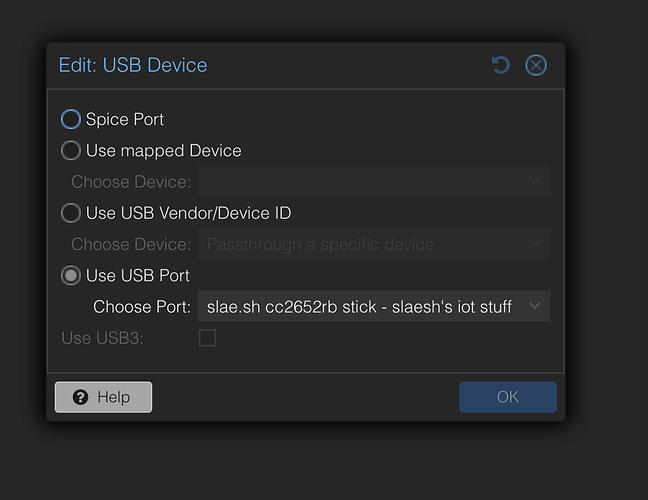

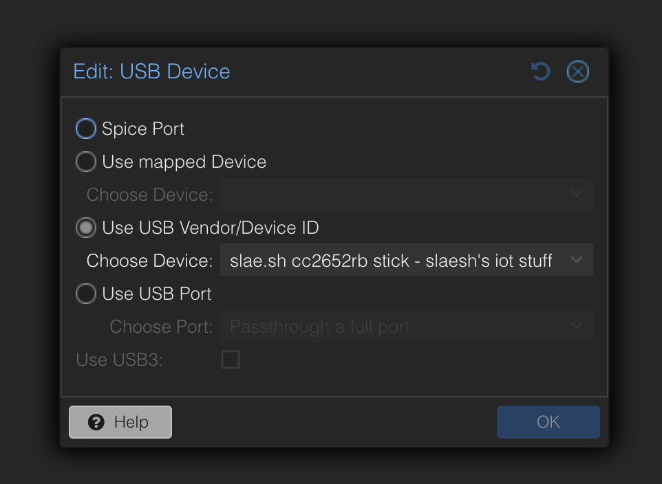

If it matters, this is how I’m passing down the USB device to the machine in proxmox:
Changed the usb passthrough to be like this
and rebooted. Seems to be working for now

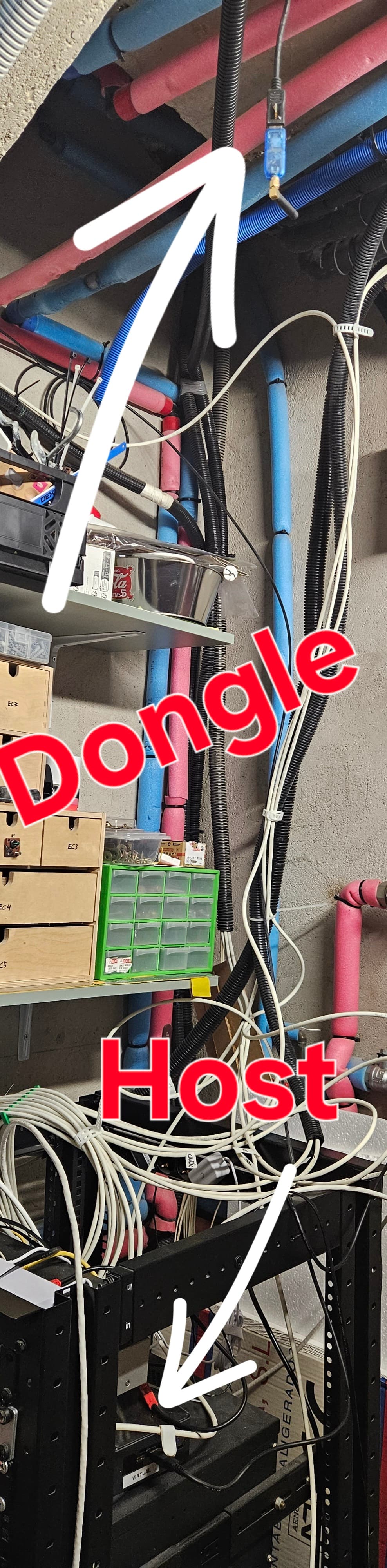

Symptoms like this have been caused by having the radio/dongle too close to another RF radio, like a USB3 port or another dongle. Make sure it’s a meter at least away from other things, including the host computer…
Like this you mean?
