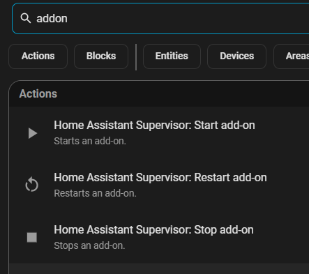

Because if so, you can use that to trigger an automation, to restart zigbee2mqtt using the restart addon action.
… assuming add-on (app) restart would help bring everything back.
I have tried that. It doesn’t work. I guess that when the bridge state changes, it’s too late. The only thing that works is PoE out/in.

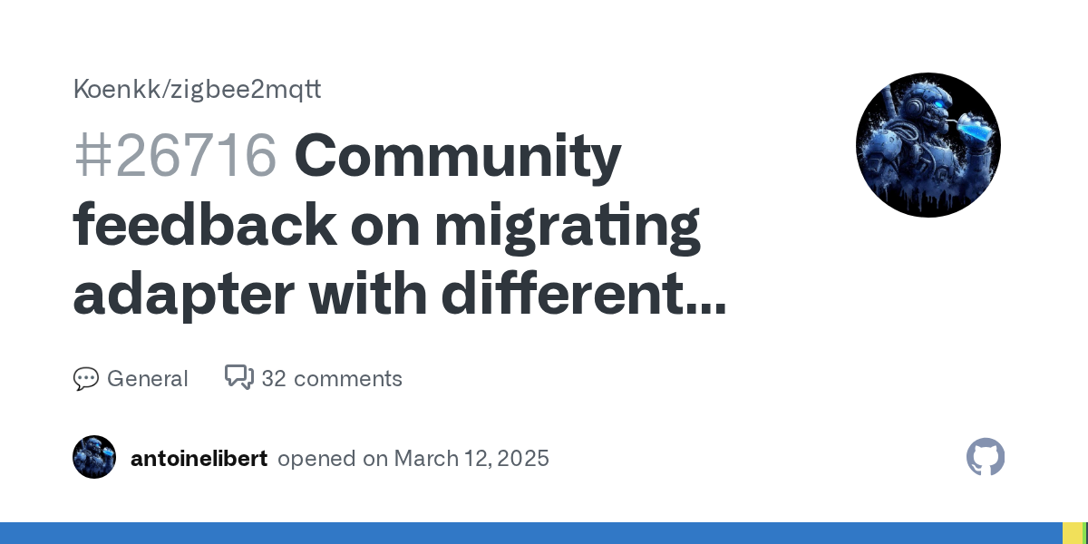

Why not try to use the EFR32 radio for zigbee? The linked thread suggests that it’s more stable.
I guess that might be a solution. but the guide for moving it (16 point list, with plenty of room for failure) has scared me off so far.

Here’s the link
Let me know if you can make it work.
