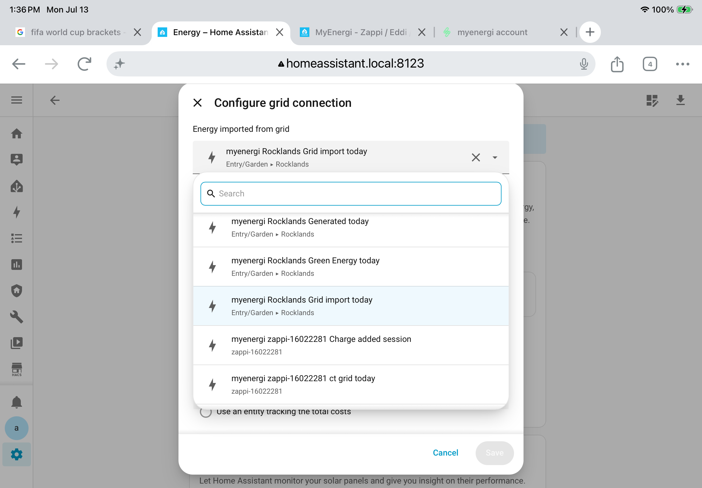

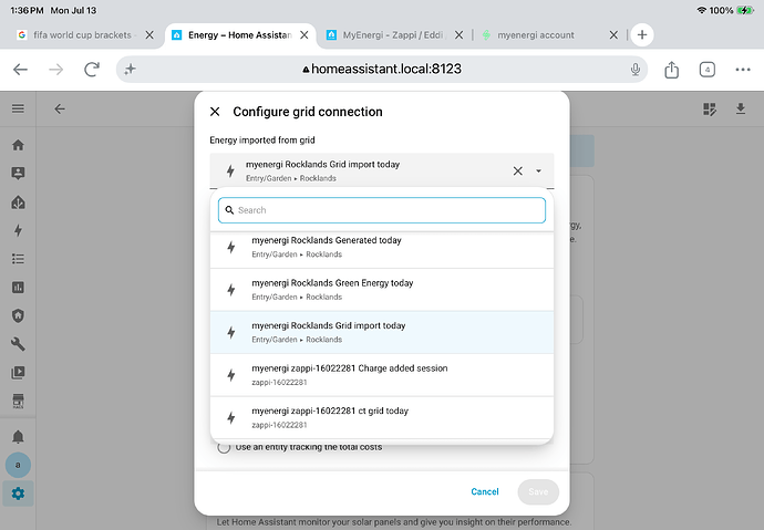

A home assistant neophyte here. Decided to try and integrate our Zappi 2.0 and Hub into HA. The electric installation at our place is unusual. We have two single phase supplies. To monitor both phases we installed a 3 phase Zappi, monitoring the import/export on both phases with 2 of the CT clamps. The Zappi happily concatenates the information, reporting the overall flow.
I’m getting confused configuring the grid connection settings in HA about sensor choice to monitor the concatenated figures. Any advice insight into choices would be greatly appreciated.
Replying to myself. Think I’ve managed to choose the correct inputs for the energy monitoring. You can ignore my request for help.Cheers
