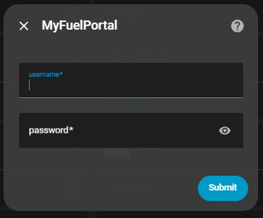

Integration config:

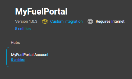

Integration installed:

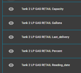

Entities:
