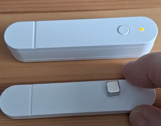

Just a FYI. I recently bought four MYGGBETTs, and got them working via HA Green, ZBT-2, Thread, etc.
One of the four has a much weaker magnet in the thin part than the others. If you find one not very sensitive, try using a known good magnet to check its response.
I’m piggybacking a strong rare earth magnet on that one. As such it has similar range as the other three.
