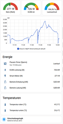

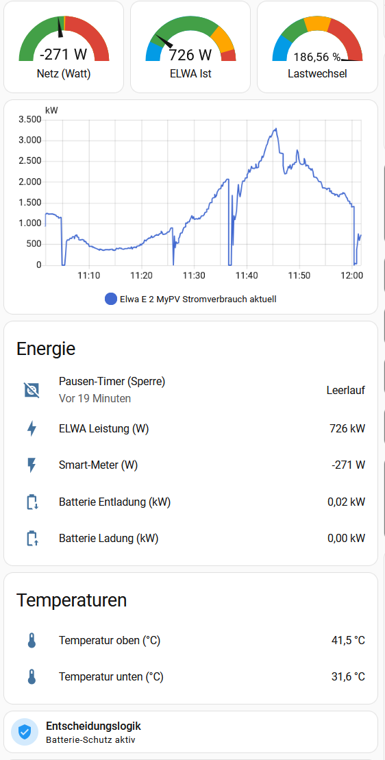

Again i redesingnt the whole steering - biggest rules! 1: not Battery drain 2: no Grid use 3. maximum availabe Engery for the Elwa.
!! Change All ip´s to your Needs !!
!! Change All names(of your Sensors) to your Needs !!

If you want you can add this to your DASHBOARD for debug/graphic control:
type: vertical-stack
cards:
  - type: horizontal-stack
    cards:
      - type: gauge
        entity: sensor.smart_meter_summe_der_aktiven_momentanleistung
        min: -5000
        max: 5000
        severity:
          green: -5000
          yellow: 0
          red: 100
        needle: true
      - type: gauge
        entity: sensor.elwa_e_2_mypv_stromverbrauch_aktuell
        min: 0
        max: 3500
        severity:
          green: 500
          yellow: 2500
          red: 3200
        needle: true
        unit: W
      - type: gauge
        entity: sensor.smart_meter_netz_volatilitaet_1min
        min: 0
        max: 100
        needle: true
        unit: "%"
        severity:
          green: 20
          yellow: 40
          red: 60
  - type: history-graph
    entities:
      - entity: sensor.elwa_e_2_mypv_stromverbrauch_aktuell
    hours_to_show: 1
    refresh_interval: 10
  - type: entities
    title: Energie
    entities:
      - entity: timer.elwa_pause
        secondary_info: last-changed
        name: ELWA Leistung (W)
      - entity: sensor.smart_meter_summe_der_aktiven_momentanleistung
      - entity: sensor.master_battery_discharge
        name: Batterie Entladung (kW)
      - entity: sensor.master_battery_charge
        name: Batterie Ladung (kW)
  - type: entities
    title: Temperaturen
    entities:
      - entity: sensor.elwa_e_2_trinkwasser_temperatur_oben
        name: Temperatur oben (°C)
      - entity: sensor.elwa_e_2_trinkwasser_temperatur_unten
        name: Temperatur unten (°C)
    primary: Entscheidungslogik
    secondary: >
      {% set smart =
      states('sensor.smart_meter_summe_der_aktiven_momentanleistung') | float(0)
      %} {% set batt_dis = states('sensor.master_battery_discharge') | float(0)
      %} {% set batt_chg = states('sensor.master_battery_charge') | float(0) %}
      {% set temp_top = states('sensor.elwa_e_2_trinkwasser_temperatur_oben') |
      float(0) %} {% set temp_bot =
      states('sensor.elwa_e_2_trinkwasser_temperatur_unten') | float(0) %} {%
      set pv = (smart * -1) if smart < 0 else 0 %} {% set reserve = 100 %}
      {% if temp_top >= 60 %}
        Temperatur-Pause aktiv
      {% elif batt_dis > 0.01 %}
        Batterie-Schutz aktiv
      {% elif smart > 0 %}
        Netz-Schutz aktiv
      {% elif pv <= (batt_chg * 1000 + reserve) %}
        Kein echter PV-Überlauf
      {% elif temp_top < 55 or temp_bot < 45 %}
        ✔ ELWA darf heizen
      {% else %}
        Bedingungen nicht erfüllt
      {% endif %}
    icon: mdi:shield-check
    icon_color: >
      float(0) %} {% if temp_top >= 60 %}
        amber
      {% else %}
        blue
      {% endif %}
