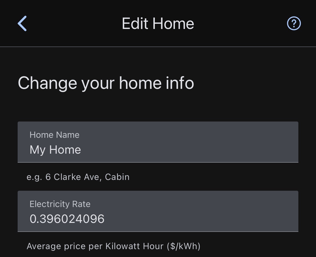

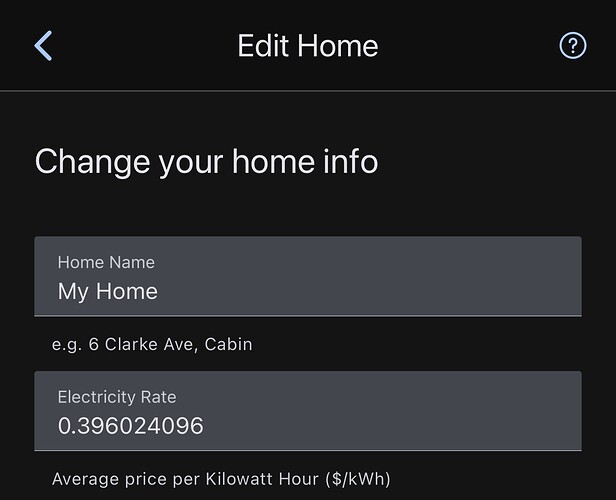

Electricity rate is pulled from app info but you can override it with mysa_extended but otherwise you don’t need mysa_extended
Version 0.8.10. I have my electricity rate set in the Mysa app but I’m not seeing it in HA.
