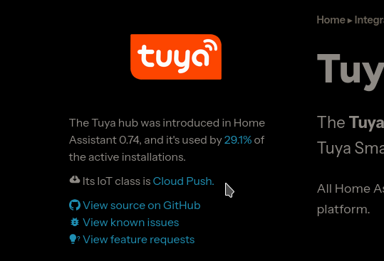

I’ve seen Tuya lights do that if it happens to take too long to get to China and back during that moment.
Before purchasing these devices, I had done some Google search and one reddit thread said that Tuya Zigbee devices call home (China?) only if they are configured via the SmartLife or Tuya app. If they are added to HA using a local dongle, then they are 100% local. If that is the case, then they should not reach out to anything outside of my local network.
The HA integration is a cloud push, meaning it talks to China.
It was originally written by Tuya themselves.
Next time read the actual Docs instead of reading the always dependable Reddit or a Google AI.
He’s using the Tuya devices with Z2M via a Sonoff coordinator. There is no Tuya or cloud involvement even remotely possible, unless the devices are also paired to a separate Tuya hub
