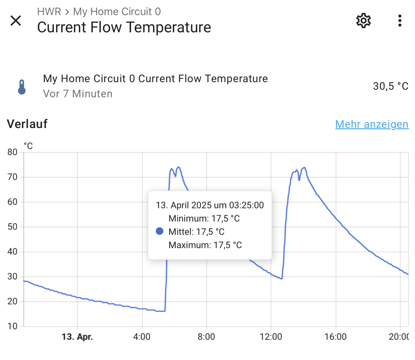

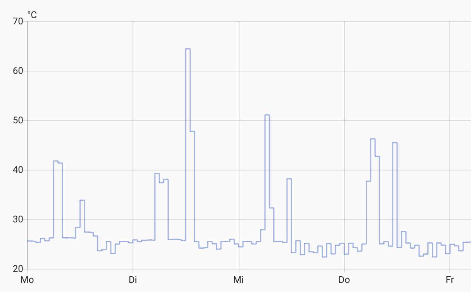

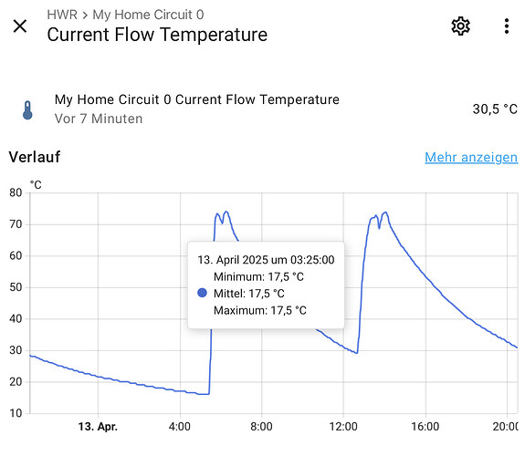

system_flow_temperature is the temperature which leaves the heat pump. the hydraulic station (the threewayvalve) then may send this water into the heating or the warm water buffer.
As our heating is currently disabled, it’s only warm water:
in winter we can see heating and warm water alternating:
In winter the temperatures <30° are water for the heating circuit, the temperatures >30° are water for hot water.
As currently we have our heating disabled, the heating buffers temperature is nearly constant:
The spikes are the overheating, as we had a very sunny spring, it was nearly constantly overheating (via SG Ready). But this temperature is (afaik) not available in the API.
Here is the threewayvalve alternating between heating and warm water:
Here it’s shown, that the valve does not send water from the heat pump into the heating circuit, it always points to warm water.
I’m not aware of a method to invoke Arotherms SG Ready program via software. But I can trigger my solar inverter via HA to send the SG ready signals (recommendation, force, lock, …).

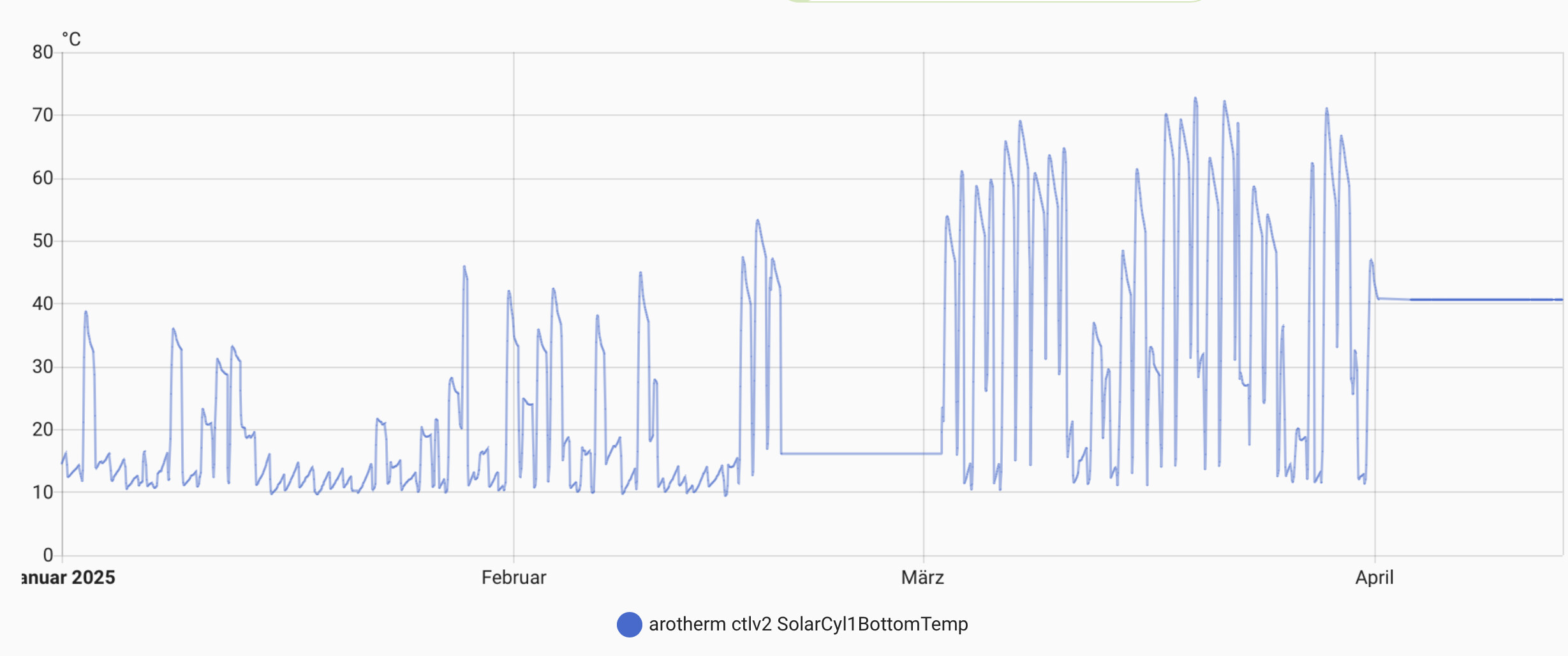

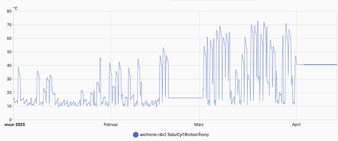

did you find a solution for this? I’m seeing the same thing, i get perhaps one reading every three days which is basically useless…
