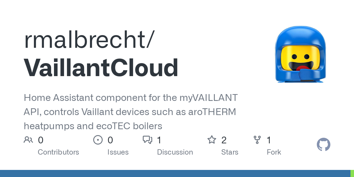

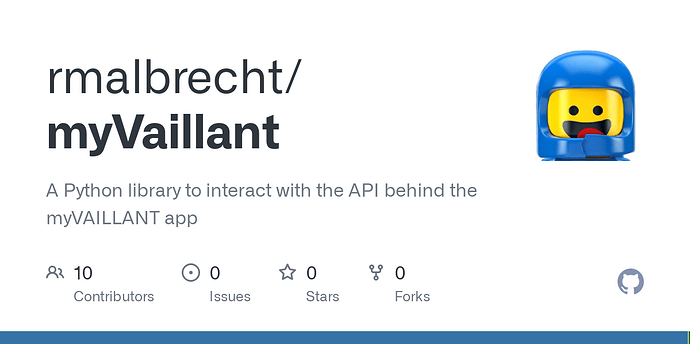

to be able to fix and make changes, I forked this integration and the supporting library.
It builds, installs and updates via HACS, has a (kind of) new HACS icon, has several updated libraries, has more test-data, has some more countries, two more sensors, …
I also updated the documentation and started to document the API itself.
It works for some weeks on my installation without any problems.
It can be installed in parallel with myPyllant.
If somebody is interested in collaborating, I’m happy to grant rights to the repositories:
cu romal
