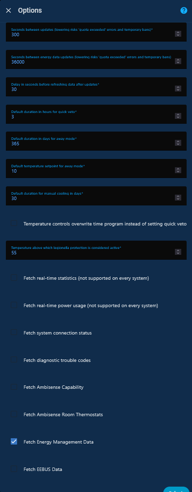

Please, have a look on above history of this entity… and on my paramaters settings below:
What to do if my Vaillant VR921 Controller is being considered as OFFLINE or UNAVAILABE for such a long time? If I’m able to fully control my Vaillant devices and their data via Android App, then WHY am I NOT able to do the same from myVaillant HA integration? This is clear to me that the root cause is somewhere in the integration, not on my network or my mobile app sides.

I still have the problem that I don’t receive any energy values for days. Now again since Friday. Isn’t there a way to configure it so that it works stably?
I have a similar situation. Usually it works through a week, then dies on Friday or Saturday. Then recover on Monday. It looks like weakly quota reset at week beginning?
I have enabled Fetch real-time power usage and Fetch Energy management Data.
450 and 3600 secs, for updates period and energy update period respectively.
both update interval are set to 3600 secs on my installation
