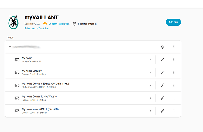

Facing the same issue. I am using this integration just to pair my Saunier Duval 18KKS with HA. Heating is based on the scenarios for every single room separately together with smart thermostats mounted on radiators.
With “My Home Zone 1” left in peace (heating permanently) everything is OK.
Manual changes to values result with disappearing of home integration.
With the integration being unavailable whole heating system is out of order.
God only knows what makes it come back. Just tried re configuring/ reinstalling or just waiting. But this is not how it supposed to be organised.
Changed seconds between the updates to 600 and it helped.
Right now, although changed to higher values the same scenario reappears.
Hints how to make it available are appreciated.

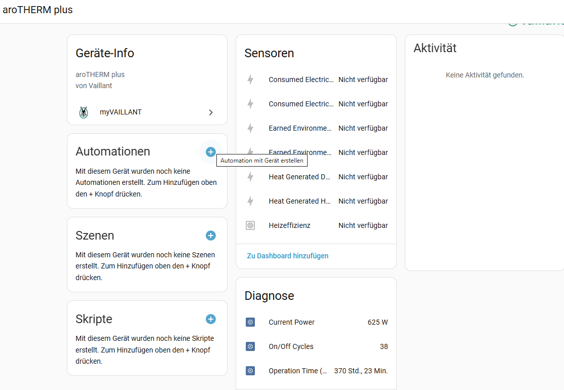

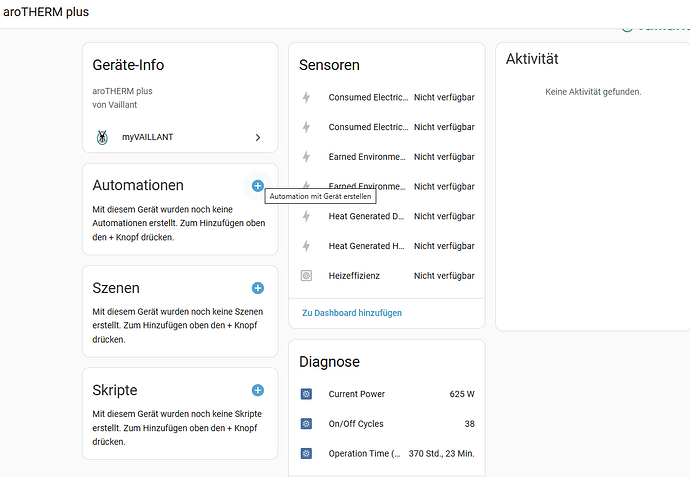

Dear all,
I’m using this integration since a couple of days. While the controller, the domestic water and the heating circuits are regularly reporting values, the heatpump itself has issue: While the diagnostics are updated from time to time, the sensors appeared, but whether receive data only once after reload of the integration, or not at all (maybe after a reboot?):
I assume this plays a role? Update interval is 300, update interval for energy data is 300 as well… maybe too often?
Can somebody help? The COP (“Heizeffizienz”) would be really nice to know… Thanks a lot!
Hi! I wanted to chime in to help troubleshoot.
I am running a fairly heavy setup myself (using AmbiSense with multiple zones), which typically generates more data traffic. However, I have not experienced any quota issues or 403 errors recently.
Looking at the error 403 Quota Exceeded, it definitely points to rate limiting.
I checked my own stable configuration, and I believe two settings are key to keeping me within the safe zone. Could you compare these with yours?
  1. Update Interval: I have set my “Seconds between updates” to 600 seconds (10 minutes). But I noticed in your post that this is already the case.
  2. Realtime Data: I have explicitly disabled “Fetch realtime statistics” and “Fetch realtime energy consumption” in the integration options. These can trigger excessive calls.
Try increasing your update interval to 600s and disabling the realtime fetch options to see if the error clears up after the quota reset.

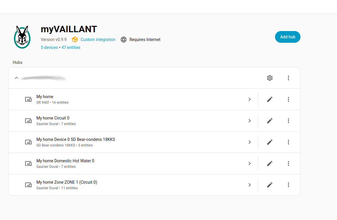

I’ve hit a problem that might be similar to what @Tobster77 documented above, looking at his screen shot.
I just upgraded to Core 2025.12.2. On reboot some myVAILLANT entitities became unavailable. The entities were the ones related to energy usage. I noticed these were all defined in one of the five devices I had.
I then deleted the myVAILLANT integration and did a fresh install. The result of this is that my number of devices dropped from five to four, and of course the energy related entities are now missing.
Can somebody shed some light on what I’ve done wrong please?

I tried a few things, ending up with deleteing myVAILLANT, rebooting then reinstalling myVaillant. Now I’m back to five devices, however the seven entities associated with Device 0 aroTHERM plus do not get updated over time. All other entities associated with the other four myVAILLANT devices are updated on a regular basis.
** Update2**
I’ve tried to sort this and noticed each time I boot my HASS I get an energy reading then no further updates, it just straightlines at no additional energy used. So, it seems to me the entities are not being updated over time.
** Update3 - SOLVED **
So, looks like it was my problem. At some time during the 2025.12 update process I made a lot of changes. In the processI managed to delete the update time for Energy so it was blank. I added a value and it is now working just fine. Plus I’ve moved to 2026.1 and everything is still working correctly.

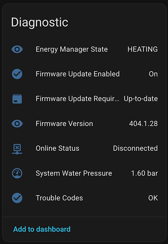

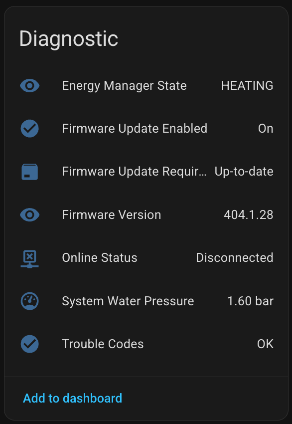

I’m having problems with the myVaillant Connect VR 940f gateway, which is turning on the red light from a ‘communication failure’. The gateway had been functioning properly for four months, but suddenly it started displaying a red light. Powering off/on the gateway clears the problem. There is no loss of networking communication and no errors in either the Vaillant system or Unifi networking.
I installed the myVaillant extension to detect any failures, but none of the entities show any issues. The Online Status field for the VR 940f shows the gateway as permanently disconnected and can’t detect any offline condition from any entities in HA. If I could detect the failure, then I could automate the power off/on.
I’m using it with an aroTHERM plus heat pump. What are others seeing with this status field?
In the exchanges with Vaillant, their next suggestion is to replace the VR 940f. It would be interesting to understand whether the online status field is useful.
The “Online Status” shows always “Disconnected” in the configuratin with my aroTherm plus 105/6. In my opinion this is a bug, as myVaillant connects to the Vaillant cloud. There would be no data if the VR 940f gateway would be always “Disconnected”. Additionally the Vaillant App wouldn’t function properly if the heatpump is noct connected to the cloud.
I’ve been running this integration for about two year, Just updated to the latest version last night. This morning all the entities were unavailable. In the logs I found the quota exceeded entry twice. Just after the update time and then no further. The log message also stated that the quota would be replenished about two hours later. Still no joy this morning.
Does anyone else have the issue and managed to solve it? Or is it a Vaillant server issue coinciding?
After a bit of digging, three field updates were disabled in release v0.9.8 due to quota errors:
  • Fetch system connection status (default off)
  • Fetch diagnostic trouble codes (default off)
  • Fetch Ambisense Capability (default off)
You can see the changes here: Comparing v0.9.8...main · signalkraft/mypyllant-component · GitHub
I went to the file const.py in the directory custom_components/mypyllant and turned two fields back on:
DEFAULT_FETCH_CONNECTION_STATUS = True
DEFAULT_FETCH_DTC = True
I then rebooted Home Assistant.
The status is now coming through. I did not change the default update interval.
DEFAULT_UPDATE_INTERVAL = 30 * 60  # in seconds
I will see if I can detect the failure and get a diagnostic trouble code as well.
You are right. I was not aware that the “Fetching system connection status” is configarable. I tried to set it to true and the “Online Status” went to “connected”. But this change braught my configuration (version v0.9.9) back to quota errors. Therefore I disabled “Fetching system connection status” again and avoid the quota errors (main intervall 60 and 5400 for energy data)
