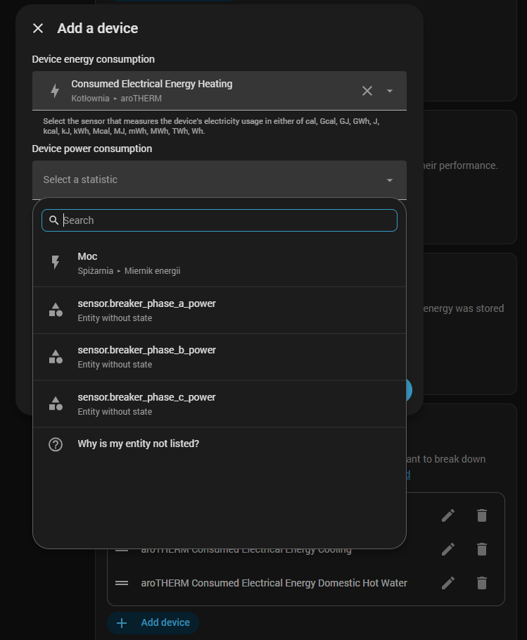

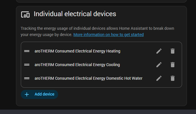

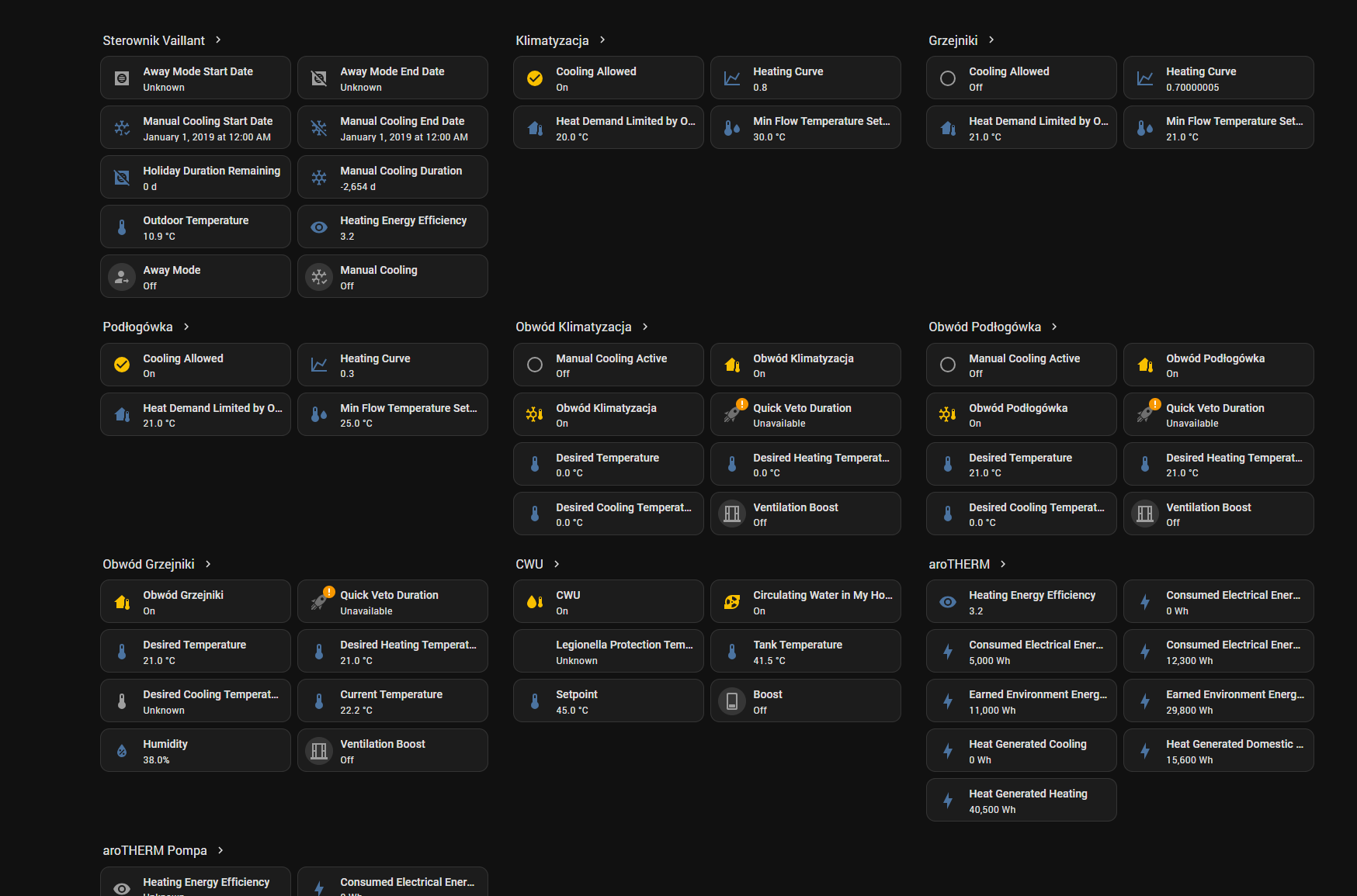

I have issues with Energy page. All elements of the Device page look OK, incl. Consumed Electrical Energy …:
I added these elements in the configuration of the Energy page:
But it does not show diagrams on the Energy page.
Maybe something is missing in the Energy configuration:
The help page (Expected data source not listed - Home Assistant) suggests to add respective devices manually to the Recorder configuration.
How can I do it? I’m quite new to HA.

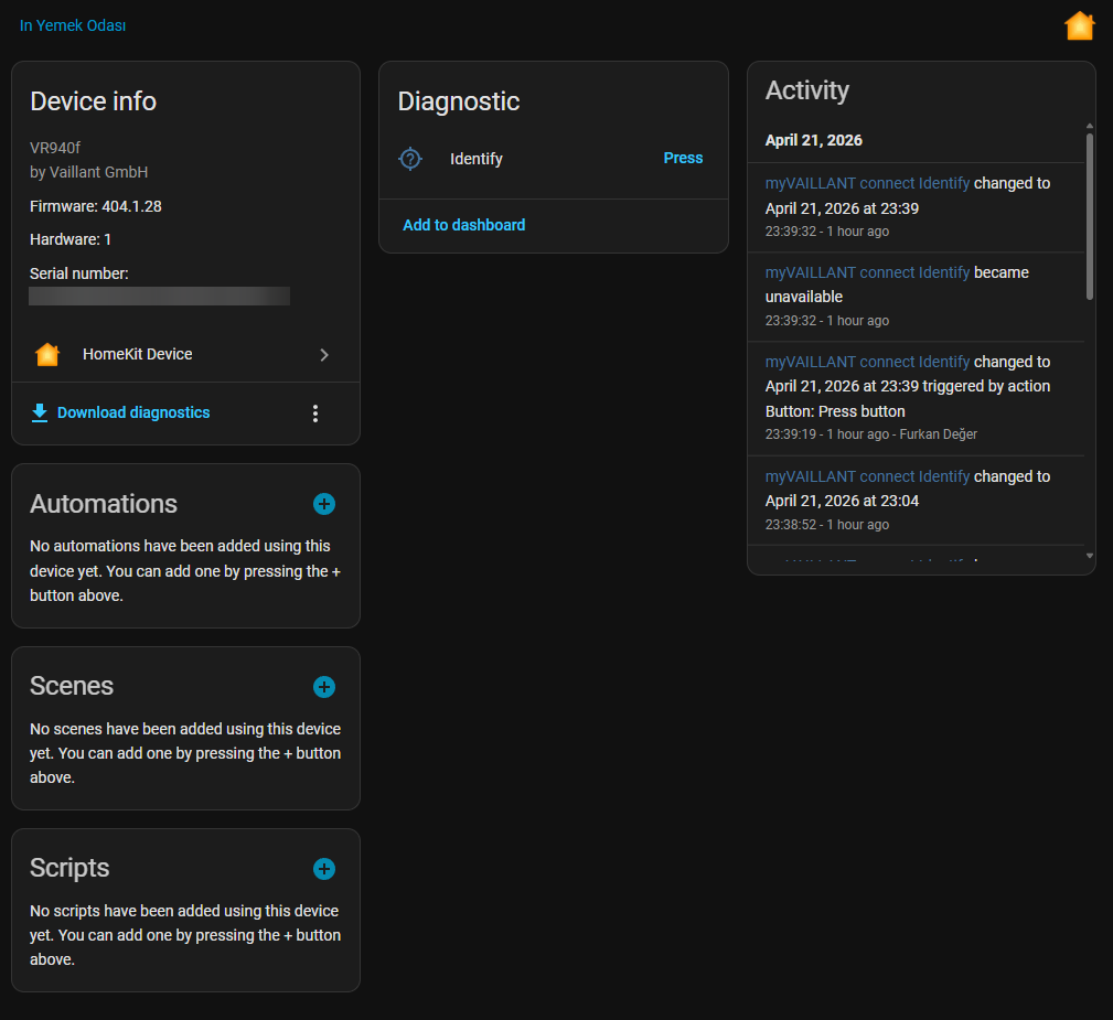

Hi, this is probably a long shot but I have the VR940f and connected it through homekit device integration; however, it only seems to expose the identify entity (which makes the led on the device blink purple, yay :D):
Not sure if this can be improved. According to actual Apple Home users it should be able to allow temperature and heating mode control but… I don’t know.
Maybe someone else can chime in?

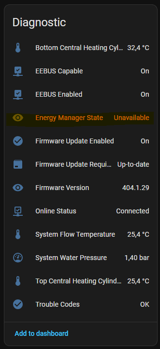

Few days ago, Energy Manager State worked displaying if we were in heating, cooling, hot water mode. It stopped working.
Any idea why ?
Device info
VR 940
by Vaillant
Firmware: 404.1.29
Best regards
Works for me. Check the logs to se whether you hit the API quota

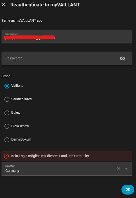

Heyho!
Since the last update, I got a problem with the Login:
I tried to reinstall the component. The normal Login at myVaillaint is working without any problems.
In my installation, the integration didn't even started
