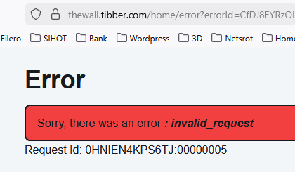

I followed the same instructions but I didn’t get it working :frowning:
Is your system open to Internet or not?
