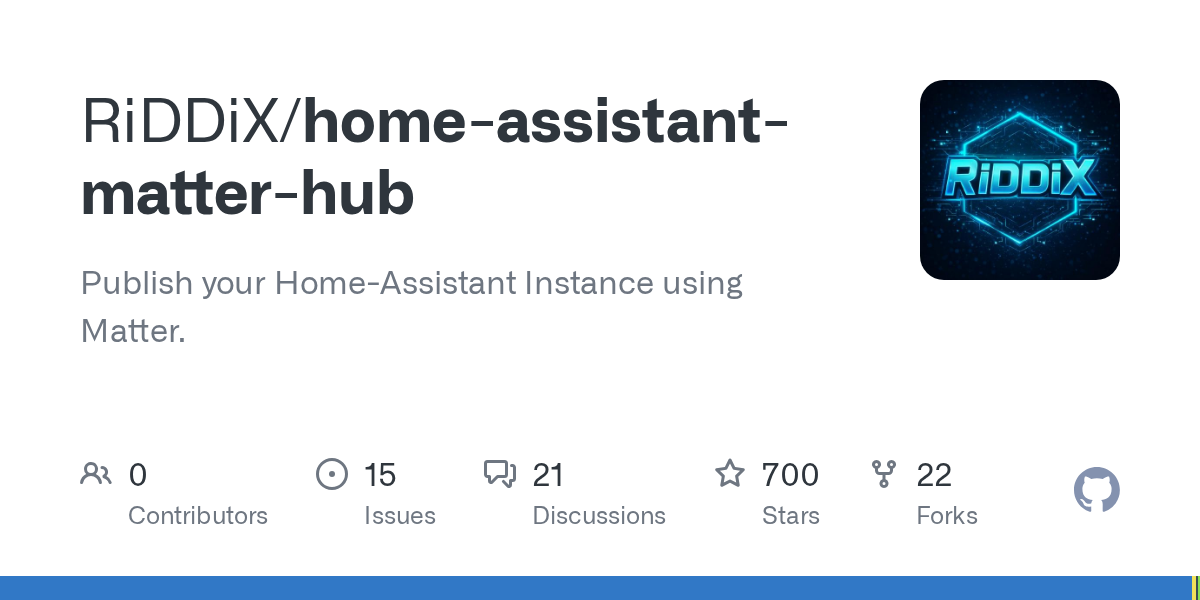

Make sure you get a maintained one. Some are abandoned, but will probably hit high in the search results because they have been around for long, while the newer ones will be last in the search results. Search on GitHub directly is the best way.
I think this one is one of the newest.
Thanks, that’s the hub I have installed. Haven’t pulled the trigger on swapping yet though
