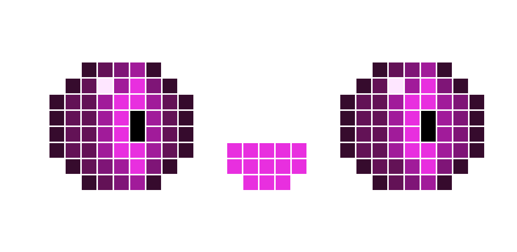

nabu_idle_dash_blue
nabu_responding_dash_blue
Features
  • Monitor multiple assist_satellite entities and switch the animation through the states idle, listening, processing, responding, and playing.

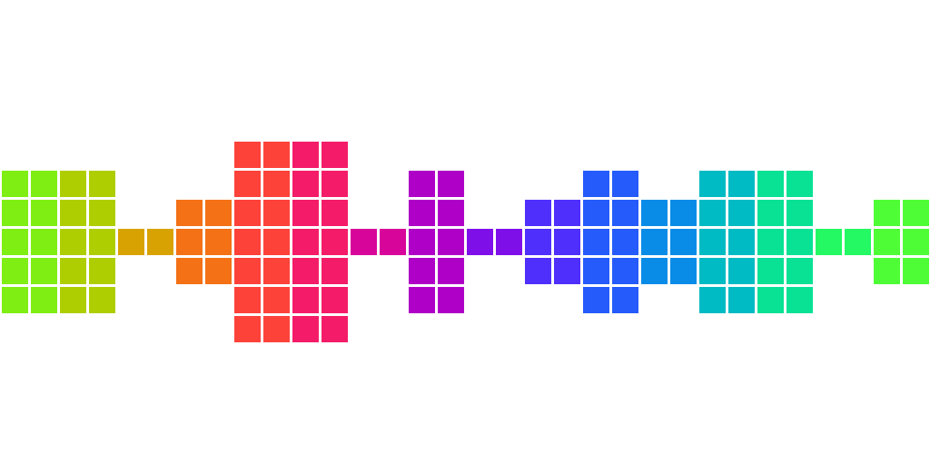

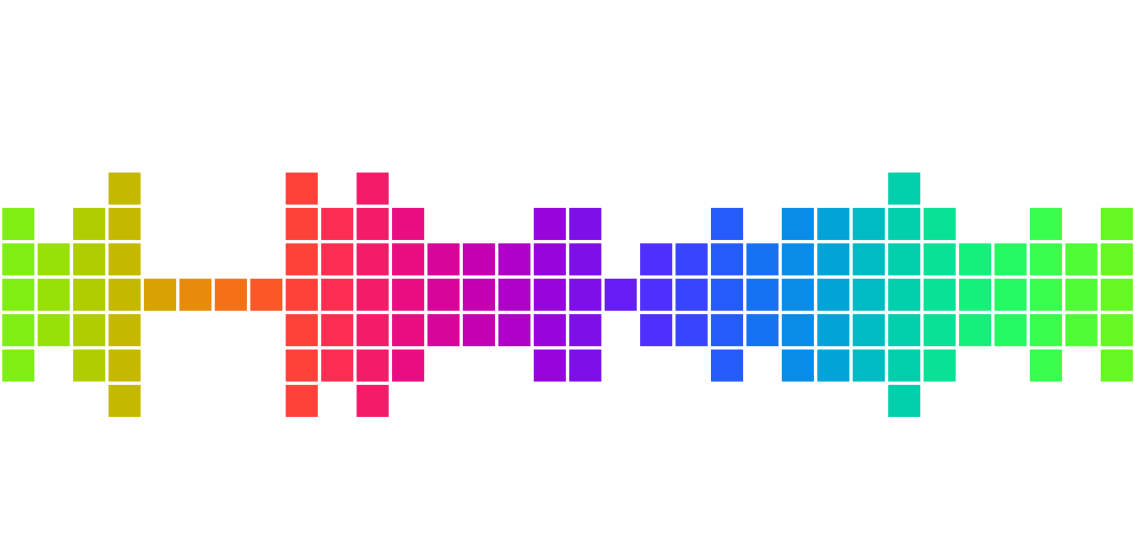

  • Media player integrations for equalizer animations and mute overlays.

  • media_player: Media player entity that controls the equalizer animation while it is playing. image
  • mute_media_player: Media player entity that controls the mute overlay. Defaults to the same entity as media_player. image

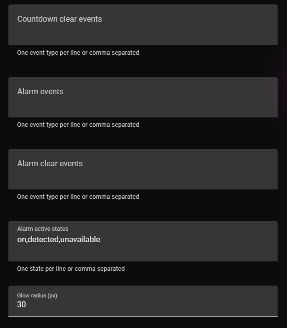

  • countdown_events / countdown_clear_events: Home Assistant event types that toggle the countdown animation on or off.image image

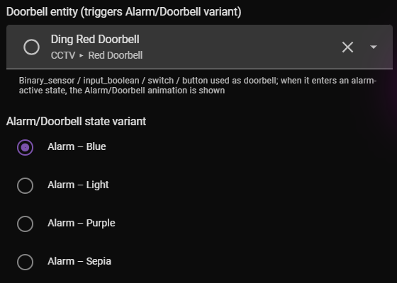

  • alarm_events / alarm_clear_events: Event types that toggle the alarm animation.image
  • alarm_entities: Binary entities (doorbells, switches, etc.) that can also activate the alarm animation when their state matches alarm_active_states.image
  • glow_radius: Glow Radius behind Nabu Eyes.image
  • vertical_padding: Vertical padding above and below cardimage
  • variant glow colours: Colour of glow behind variantsimage

@lucianoj Can you check the root folder for installation and ensure all of the variants downloaded for you? You should have blue, light, purple and sepia in the folder.
Hi, yes they are all existing within the folder and i figured otut how to configure them right.
Only light as an option is not in my folder to access
I will recheck the repository to see why that option is not downloading. You can manually add the light options and they should work.
