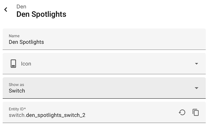

I’m using Aqara H2 switches, so each device has two “switch” entities, and it’s the switch entities I need to expose to voice assistant. Each entity also has both an ID and a name, and as best I can figure through experimentation, the name is more or less ignored by the voice assistant UI.
You still have not told us if this is the unique id or entity id.
Totally fair. That’s largely because I was unaware there was a difference! (Sorry) I was referring to the entity ID and name.
