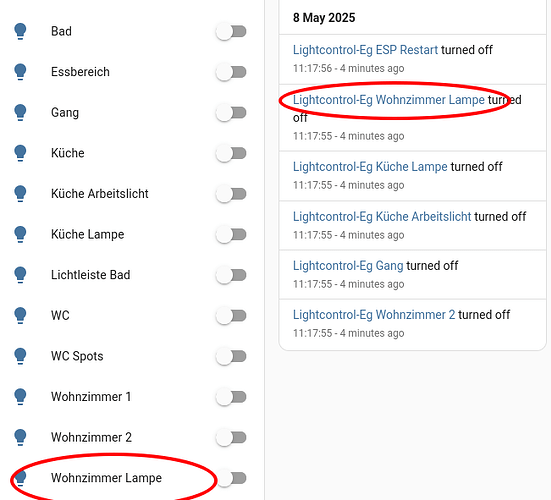

After upgrading to 2025.05, all names visible in the UI of my ESPHome devices have changed (not completely consistently). The name now includes the device name, which was not the case before. I can, of course, override it in the UI, but this is quite tedious. See the screenshot below:
Strangely enough, the name shown in the device itself has not changed. How can I get the old behavior back, i.e. remove the prefix “Lightcontrol-Eg” from my names?
