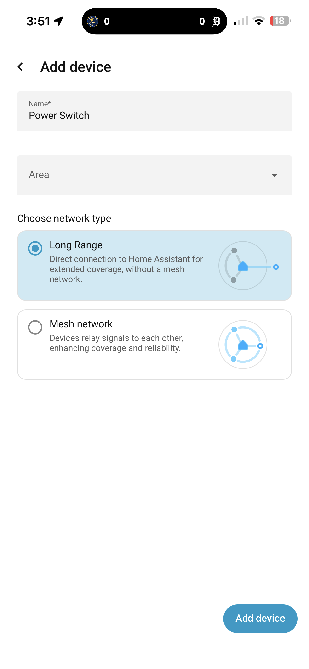

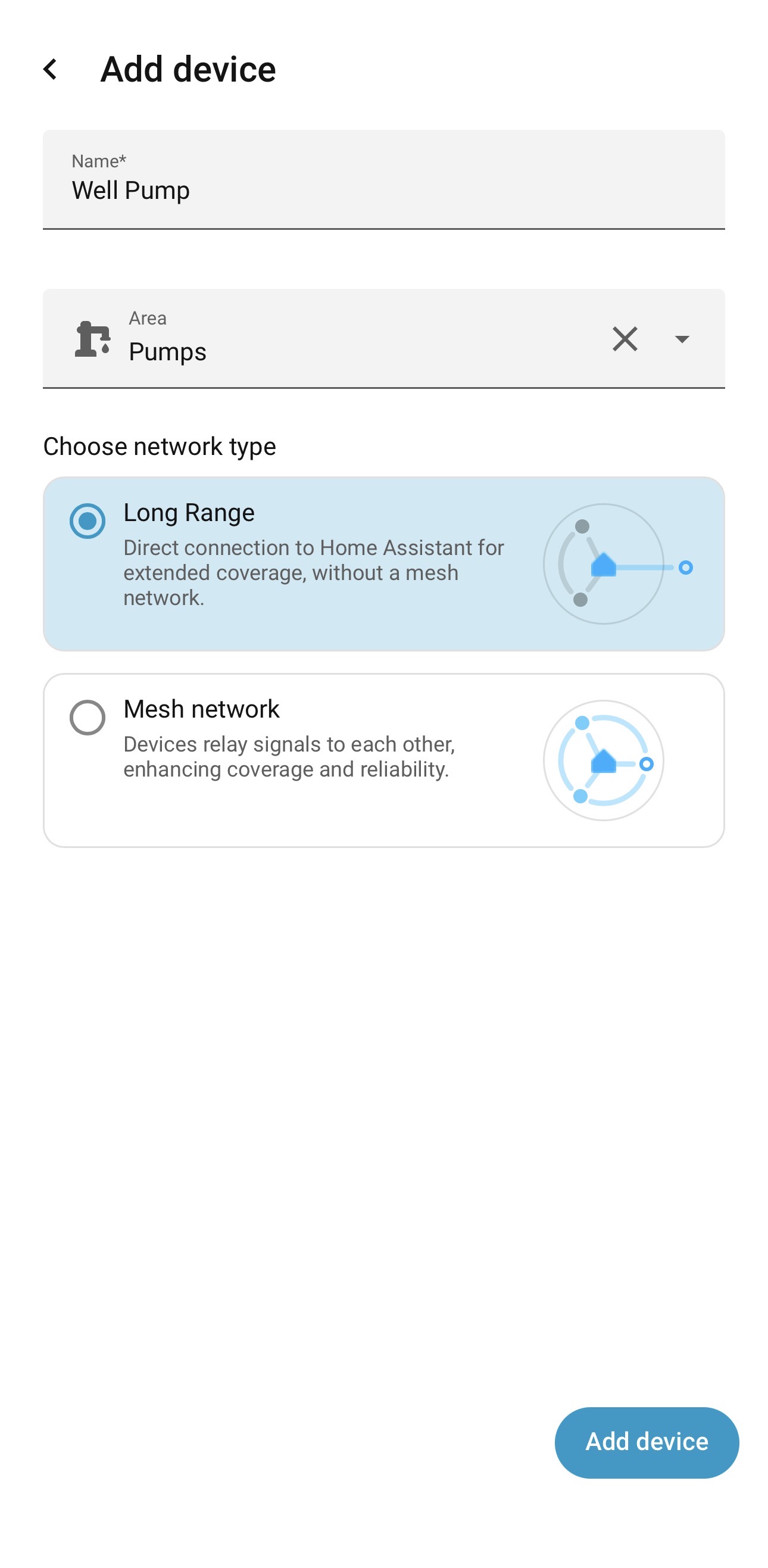

When I put a name into the field, is that what all the entities associated with it are name?
When I first tried to add it, it said Power Switch with a a space between Power and Switch. I wanted to use a naming convention so I changed it to what I have in the screenshot.
I want the entities to be this convention:
switch.well_pump_1
This explains the conventions:
Thanks! I am wondering when I add the device, will the name in the name field above I give it pass to the entities or is that the friendly name?
You are adding a device so that’s the device name. What the entity names are dependent on what the integration sets, but the rules are what were listed above.
If I understand correctly, a device name of “Kitchen Light” would leave the “main” entity (that turns the light on/of) as Null, and the entity would end up light.kitchen_light.
If there’s also a “Electric Consumption [W]” entity in that case the entity would be "sensor.kitchen_light_electric_consumption_w
The friendly name ends up with the Device + Entity Name, unless you manually change (override) it then it’s just the name you enter. Hope I have that correct and I think the plan is to always prefix the device name regardless if the name has been overridden or not.
