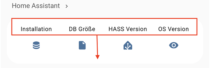

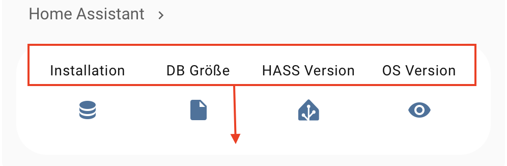

I like to use the Glance Card to display several entities side by side. The advantage of this card is that it is very easy to configure (visual editor).
The problem, however, is that the names of the entities always appear ABOVE the icon. I would like them to appear BELOW it.
Does anyone know if this is possible, or if I should perhaps use a different card for this?

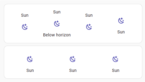

Placing a name below an icon:
type: vertical-stack
cards:
  - type: glance
    entities:
      - entity: sun.sun
        show_state: false
      - entity: sun.sun
        show_state: true
      - entity: sun.sun
        show_state: false
      - entity: sun.sun
        show_state: false
        card_mod:
          style: |
            .name {order: 2;}
  - type: glance
    card_mod:
      style:
        .entity $: |
          .name {order: 2;}
    entities:
      - entity: sun.sun
        show_state: false
      - entity: sun.sun
        show_state: false
      - entity: sun.sun
        show_state: false
The 2nd example shows how to apply the style to all entities.
Note that it looks nice only if no state is shown…
