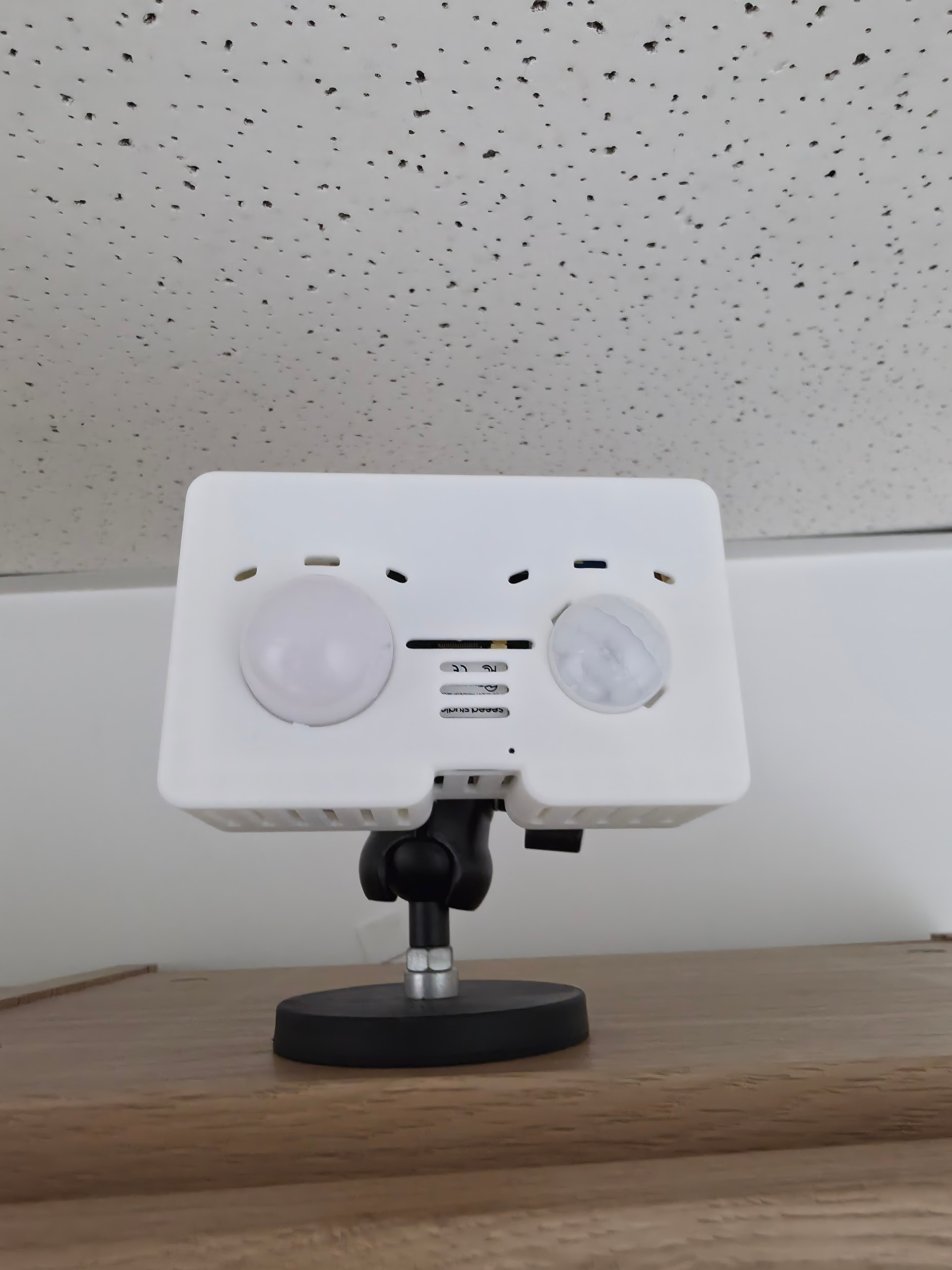

Hardware

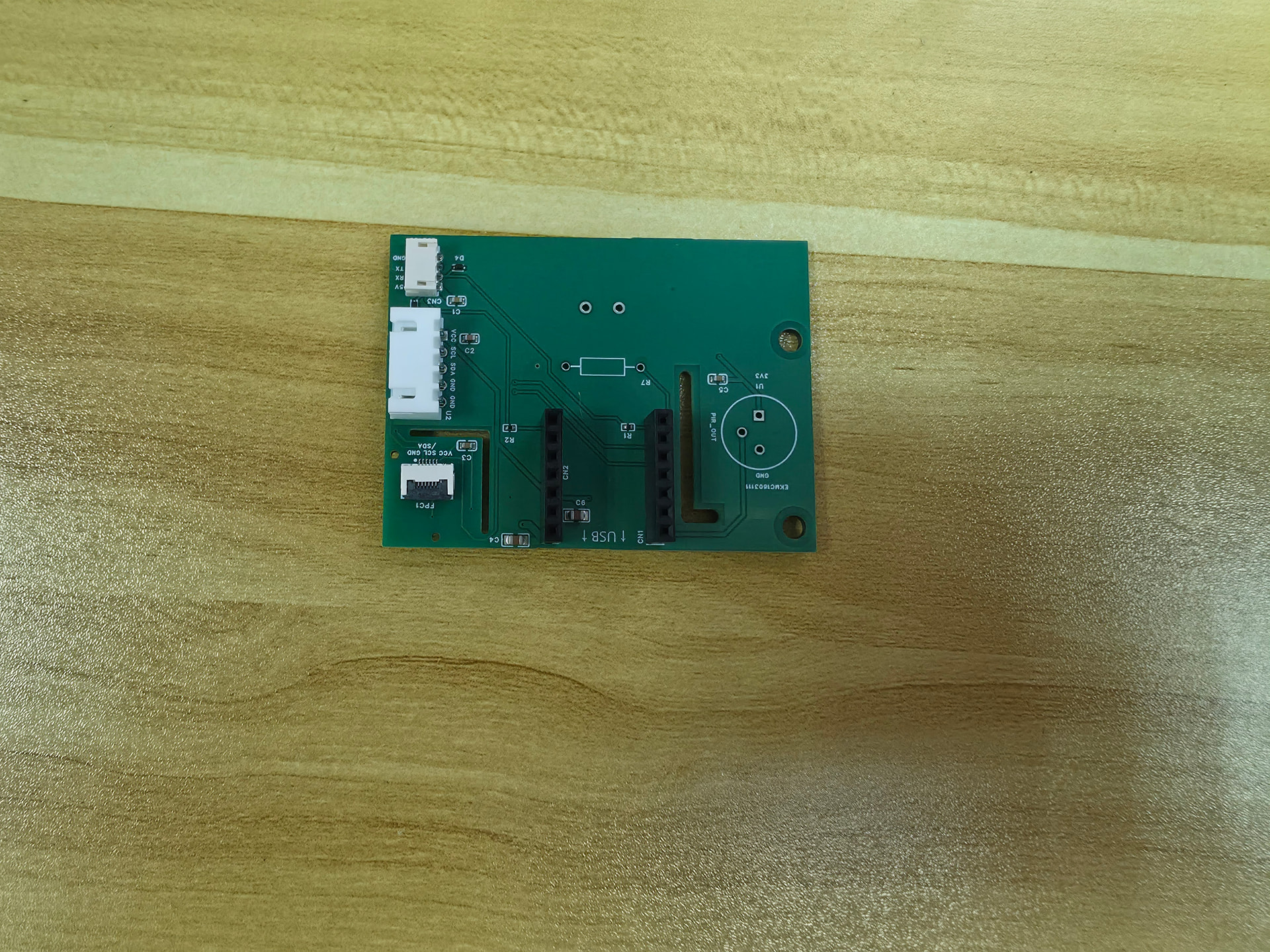

Here is the actual hardware I built for this project.
Hardware details, including the PCB design and documentation, are available here:

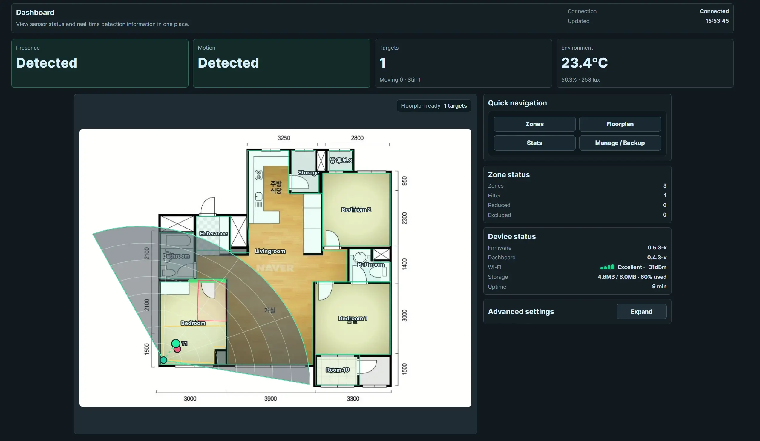

1. Dashboard
View real-time presence, motion, target status, environmental sensor data, room-level presence, and system information in one place.
The dashboard also provides access to advanced settings such as environmental sensor calibration, status LED settings, timezone selection, and diagnostic tools.

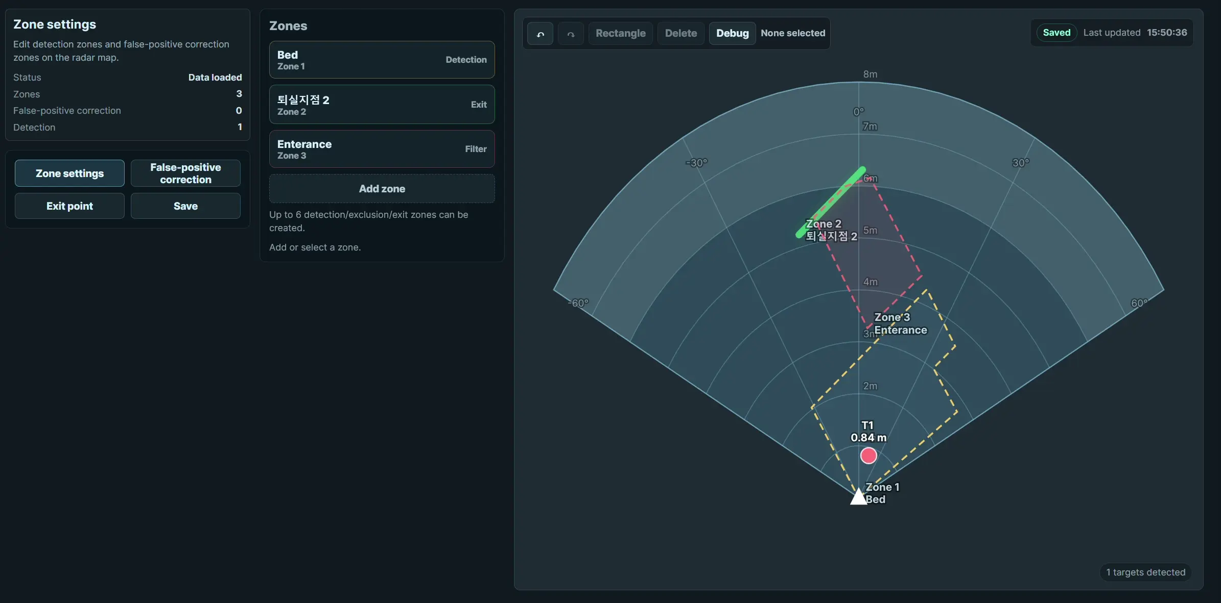

2. Radar Map
Track up to three targets using the LD2450’s native multi-target tracking capability.
You can also create and edit detection zones, exclusion zones, correction zones, and exit zones directly from the radar map.
An automatic false-positive correction feature is included, but please keep in mind that it is still experimental.

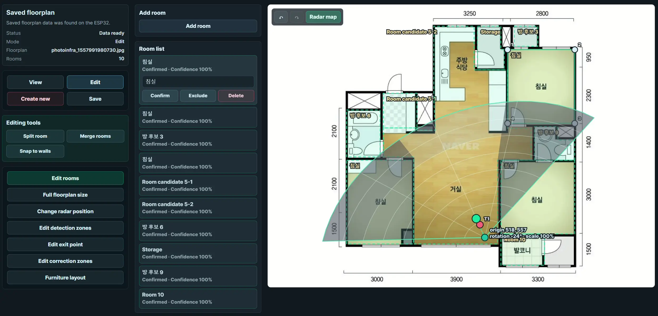

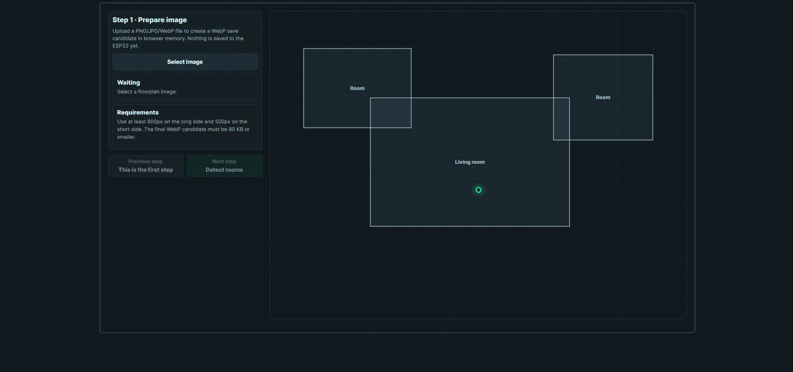

3. Floor Plan Onboarding
Upload a floor plan, define its physical dimensions and scale, analyze wall and room candidates, and place the radar through a guided setup process.
OCR currently supports Korean room labels only. English OCR support is planned for a future update.
4. Room Editing
After the automatic room-detection process, you can manually refine each detected room.
Rooms can be renamed, reshaped by adding or removing points, deleted, or created manually. My goal was to make the editing process as flexible as possible.
NAMO room editor

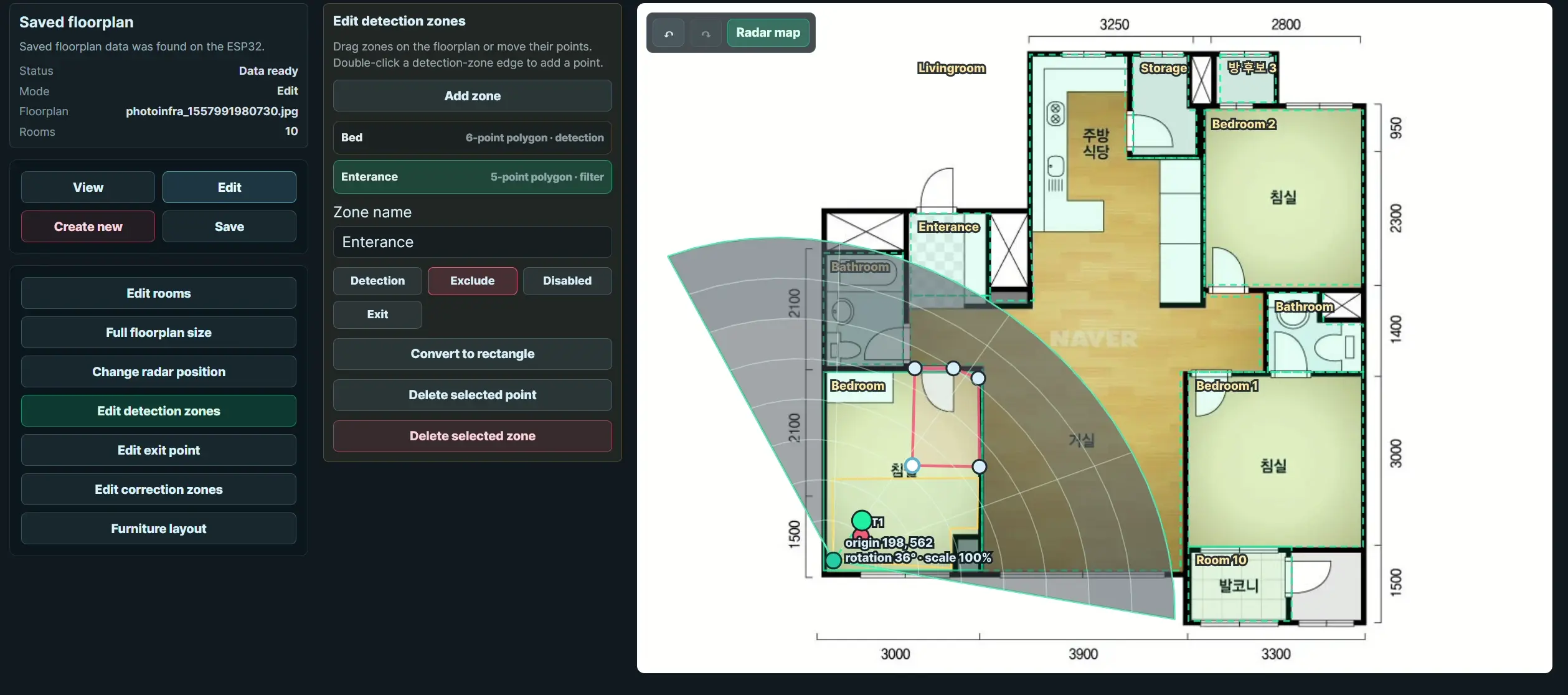

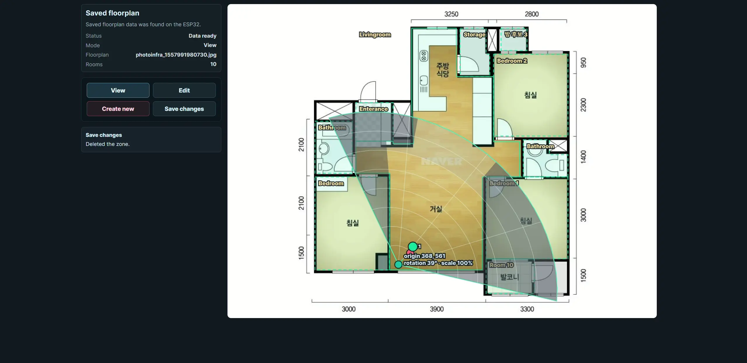

5. Radar Repositioning and Zone Editing
Match the radar’s position and rotation to the floor plan, then create and edit detection, exclusion, correction, and exit zones while viewing the actual room layout.
NAMO radar placement and zone editor

  • PCB layout and schematic
