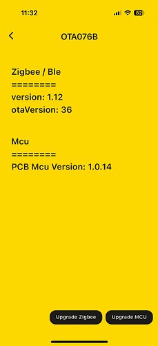

I found the app. It is called “OTA upgrade” and is not published by Namron but by a Chinese company, presumably the one that is also manufacturing the hardware.
It offers two upgrades: MCU (Microcontroller unit) and Zigbee:

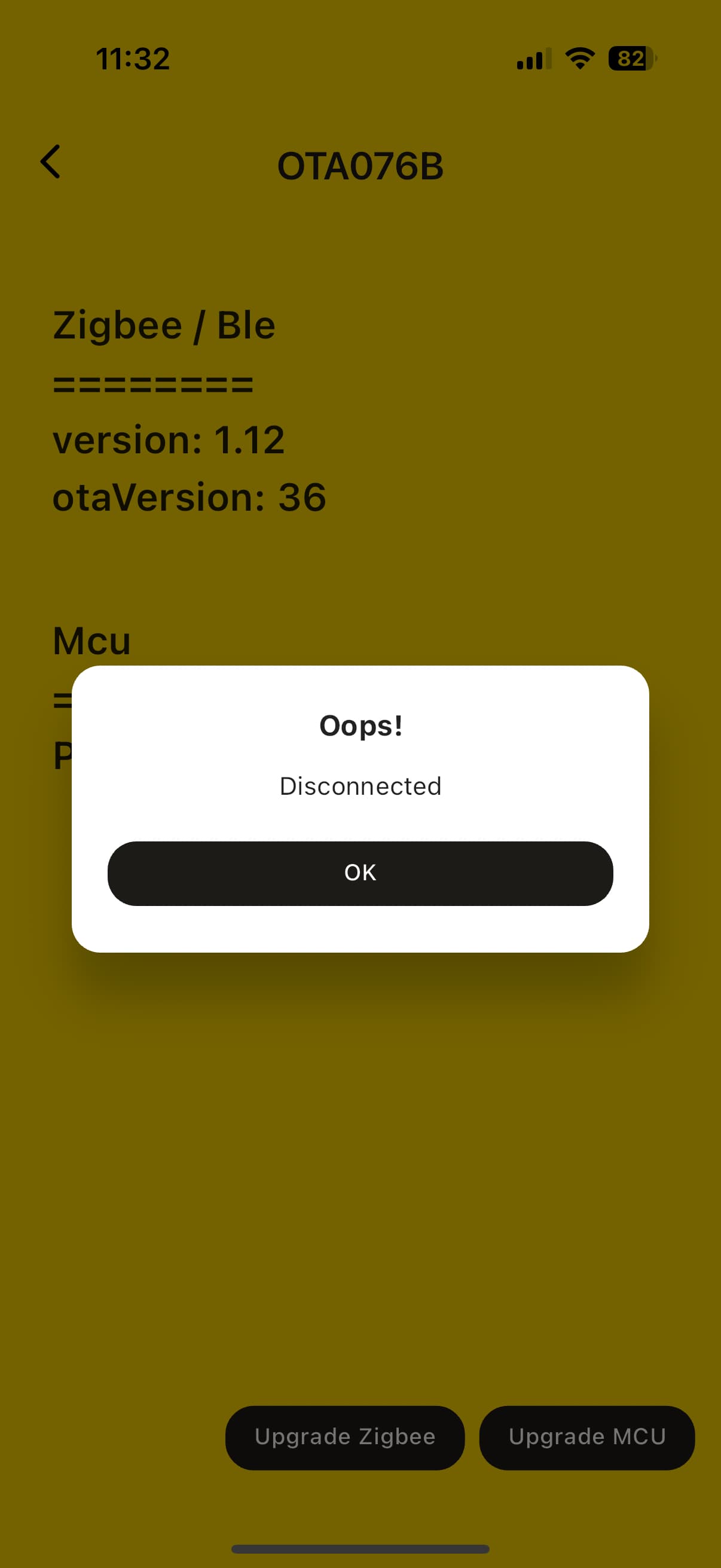

The MCU update worked (it upgraded from 1.0.9 to 1.0.14) but the Zigbee upgrade keeps failing with a simple “Oops!” error:
Turns out that that firmware version refers to the firmware of the Zigbee module, and since the update fails, I still don’t know whether there is a newer version.
I do, however, know now, that there is a higher version than 1.0.9 for the main MCU firmware. As of October 2025 it is 1.0.14. It was apparently published on 3 March 2025.
