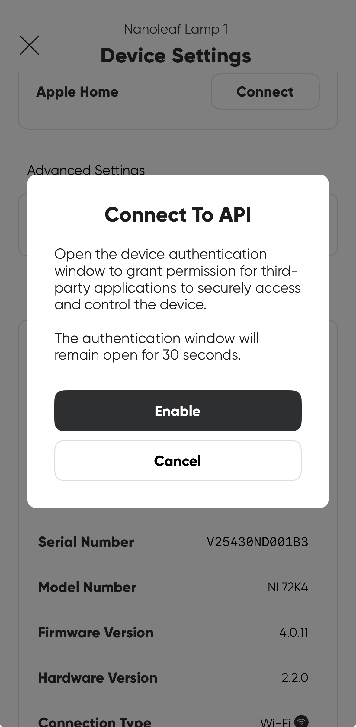

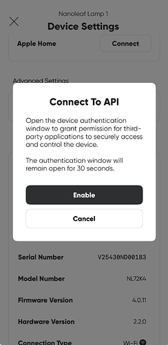

Solved it with my one, in the app go into settings for the individual lamp and in there is connect to API, I clicked that and then click enable and then submit in HA and that worked for me
