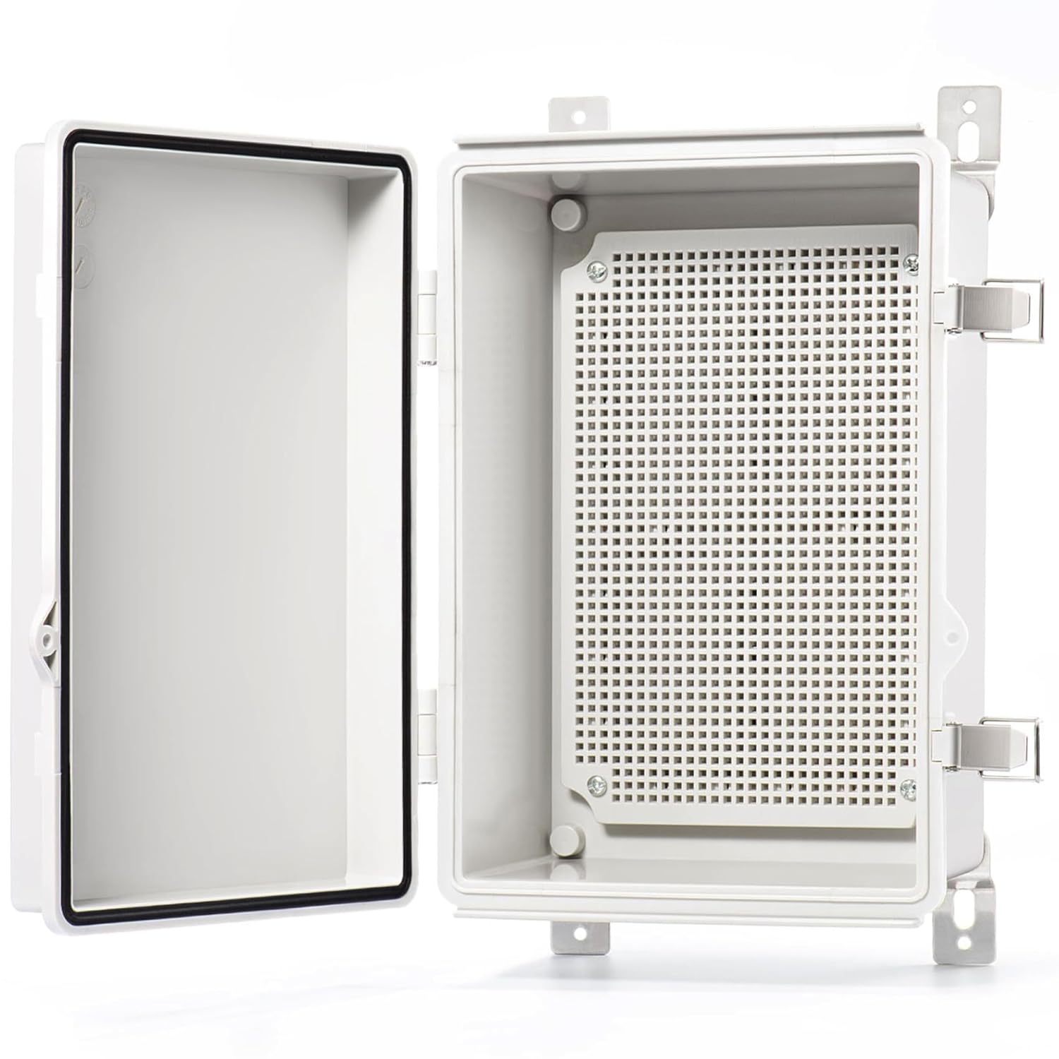

Enclosure: Hinged Grey Cover 11.2"x7.7"x5.1" (Amazon)

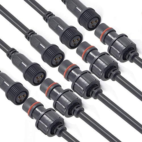

Connectors: Waterproof Connector 3wire, 16AWG Male Female Plug LED Connector with 3Pin Waterproof Connectors IP68 (Amazon)

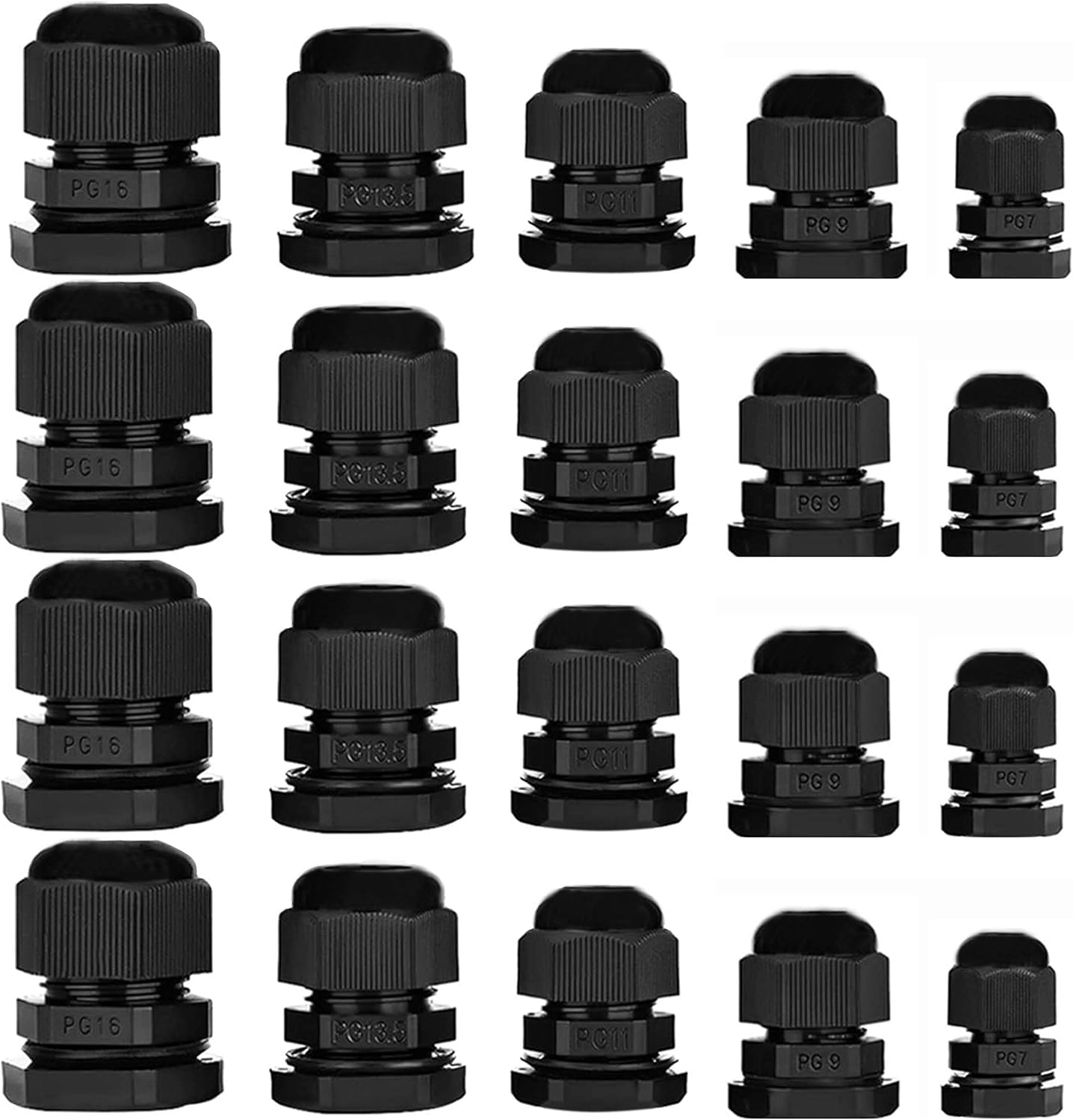

Cable grommets: Cable Gland Waterproof Adjustable 3-13mm Cable Connectors (Amazon)

FYI the IP68 cable ends are polarity reversed from NanoLeaf.

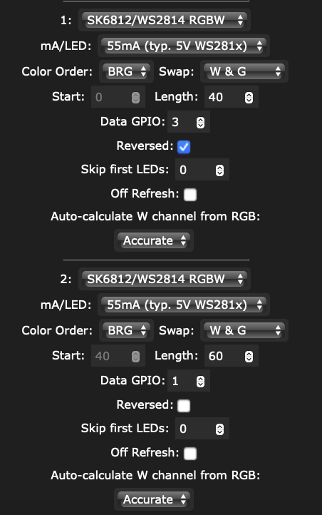

Took a bit to figure out the settings in WLED for the lights to behave properly.
I ended up using the SK6812/WS2814 RGBW LEDs
BRG, Swap: W & G

I started the project today and had got to your config through reading the docs; but currently I can’t get any output?
I’m using DigiQuad with a dedicated 3A 12V supply but can’t get any of the string to work.
Was your config for a single string ( 20 lamps)?! I’ve seen some posts on Reddit saying you need to segment some configs when converting to WLED?
