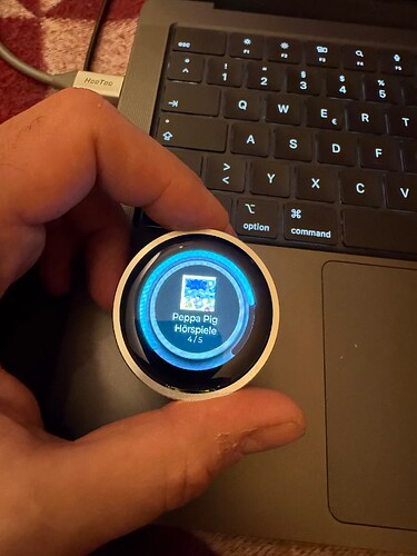

NanoPod is an iPod-inspired controller built on the CrowPanel 1.28" ESP32 Rotary Display (~€30-40). It connects to Music Assistant and provides a dead-simple interface:
- Spin the wheel to browse artists/albums
- Click to select
- Spin during playback to adjust volume
That’s it. A 4-year-old can use it.

- Three-screen navigation: Artist carousel → Album list → Now Playing
- Cover art display with dynamic loading from Music Assistant
- Dual input: Rotary encoder AND capacitive touch gestures
- Progress ring: Outer arc shows playback position
- Sleep mode: Auto-dims after 60 seconds, wakes on touch
- Lazy loading: Handles large libraries (1000+ audiobooks) without lag
