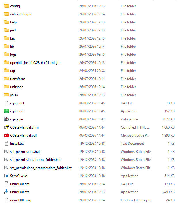

However, some confusion remains! I upgraded (recently) to C-Bus Toolkit 1.19.4 which brought with it C-Gate 3.7.1 build 2287. I did that because I saw that the AddOn wants V3. The install process was clear about how it was going to delete the older version of C-Gate, and that it would stick with the same folder (C-Gate2). This is how that folder looks now:
I think the dates of 3rd March and 26th July confirm that I have the new version of C-Gate and that some folders where changed yesterday. However, the tags folder still has just the XML file that it has always had, with no sign of a db file.

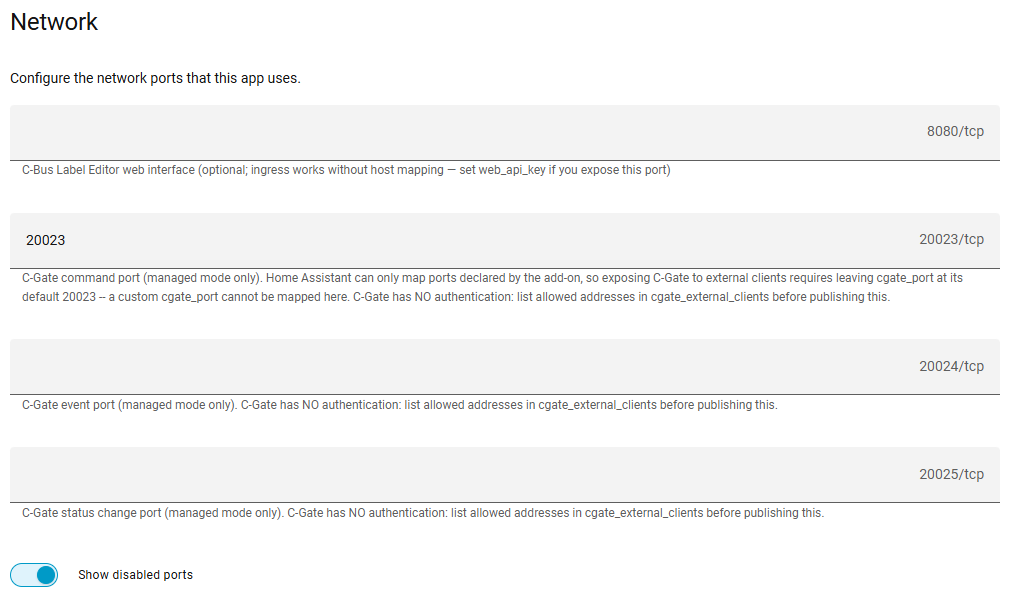

The IP address there is my desktop running Toolkit. I read in the documentation “You must also map C-Gate’s ports in Home Assistant’s Network panel”. That makes sense, but looking in Settings/System/Network, I couldn’t see anywhere to do port mapping? I am probably looking in the wrong place.

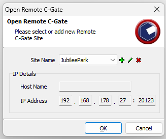

Unsurprisingly, given all that, Toolkit doesn’t connect. It is set up like this, where the IP address is the Home Assistant Green.
Any clues on this very last bit would be welcome!

Just recently upgraded from toolkit 1.17 to 1.19.4 and couldn’t get it to connect until I upgraded to cgate 3.7.1 according to this chart, toolkit version 1.18 was upgraded to TLS 1.3 between toolkit and cgate, this is what was causing me connection issues.

It looks a bit more “hard core” than that. Looking at the configuration settings in Doug’s add on, it looks like there is no way to expose Port 20123 which is a requirement for the latest versions of Toolkit to work (rather than 20023 and 20025). So from that, it feels like Toolkit will never connect.

Absolutely Doug, this will simplify things a lot! One question though, I might be missing something - but doesn’t Toolkit require Port 20123 to be used?
There doesn’t seem to be any way to enable that :upside_down_face:
