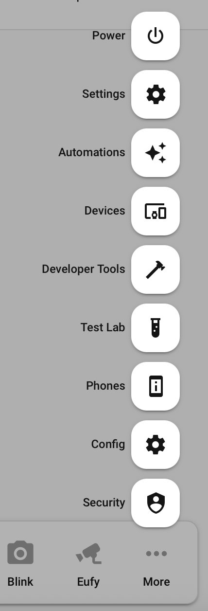

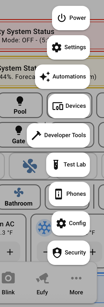

I’m wondering if I am missing something. I want to display the background for the popup labels for readability. When I add this line:
show_popup_label_backgrounds: true
the background shows up but the justification changes so the icons are now on the left side rather than the right. I’d like the icons to be on the right.
Any guidance is appreciated.

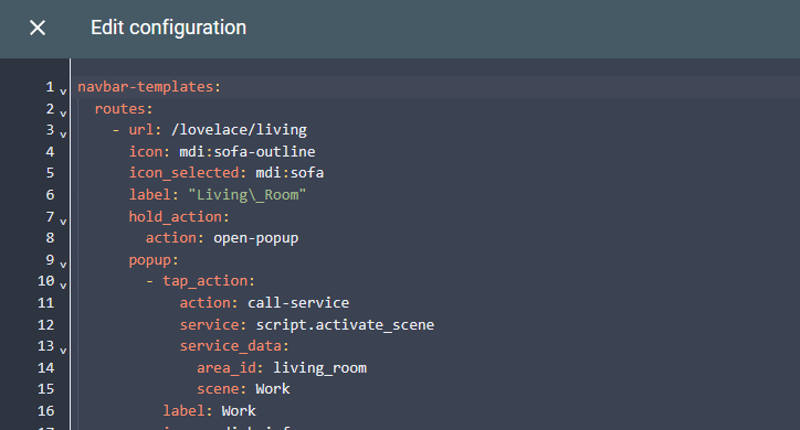

I am wanting to save my navbar as a template to easily reuse on mulitple dashboard views. Is it that within the card configuration I select ā€œshow code editorā€ and then add the code right at the top in the first line? Thanks!
navbar-templates:
your_template_name:

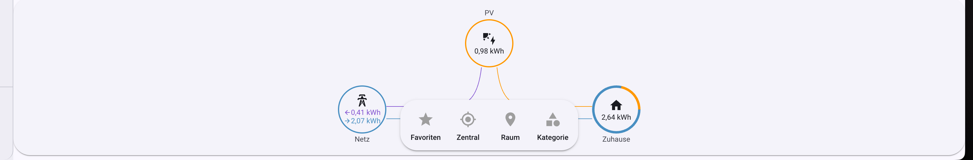

A question for you as well - is it possible to make a hover effect like this, when the background covering both icon and label, if you understand what I’m trying to say …?

For the life of me, I cannot figure out how to create & save a navbar-templates template while using the UI for managing and editing dashboards – even if I use the Raw Configuration Editor option through the Dashboard Management UI. It would seem that the majority of folks have figured this out; can someone please help me? This example yaml doesn’t make sense because it’s not a valid dashboard. HA complains about the missing view top-level attribute. (Plus, the example here doesn’t include a name for the navbar-template template, but I can handle that.) What is shown here appears to be "create a new Dashboard, use the Raw Configuration Editor to replace the entire contents of the dashboard, and save the template. That would be easy, albeit confusing, except that HA won’t save this example as it exists. Attempting to save this yaml results in HA reporting an error message of: Your configuration is not valid: a: At path: views -- Expected an array value, but received: undefined
