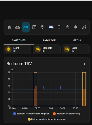

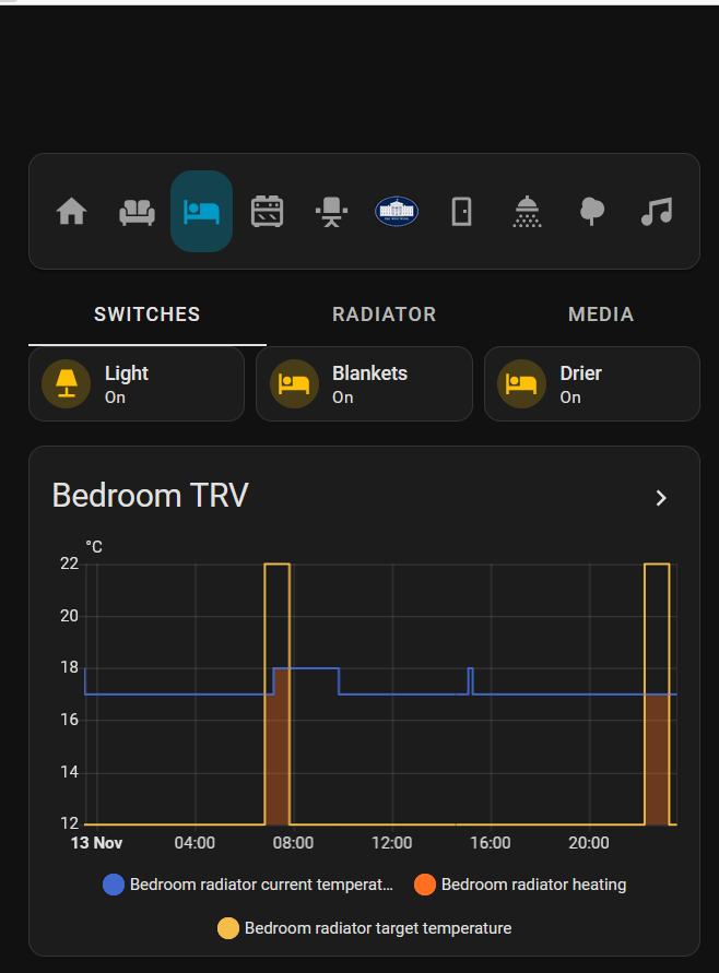

Is this dashboard done with navbar card? If so, how does it use ā€œdockedā€ in desktop mode? Or is it some CSS magic i can’t figure out?
Thank you!
Actually, most custom cards in Home Assistant use JS templates, instead of yaml. When I first started navbar-card, I looked into how other custom cards handled templating and found that JS templates were the most standardized approach.

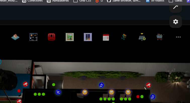

Hi @Showman03 ! That looks like the native Google Home app, or an adaptation of the Home Assistant frontend using something like this

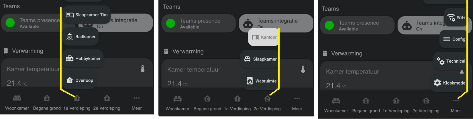

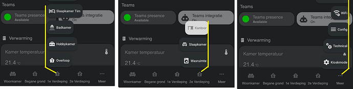

Hi, I started to experiment with the popup functionality and noticed alignement of the popup items depends on the position in the main menu bar,
As you can see in the illustration below, the left popup menu is left aligned, where the other two are right aligned.
Q: Is it possible to always have the popup items left aligned regardless the position in the main menu, so the icons are all in one line?
