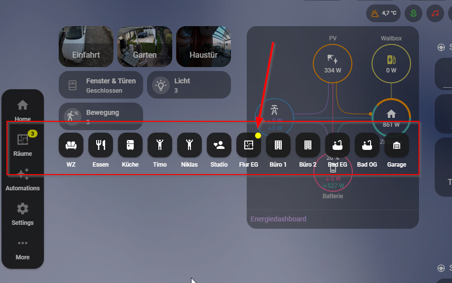

Maybe I’m not understanding something here, but you don’t actually need to add a counter. If you just configure the show option and leave the count one empty, the badge will be displayed as a small circle with no text inside. Just as you show in the original screenshot.

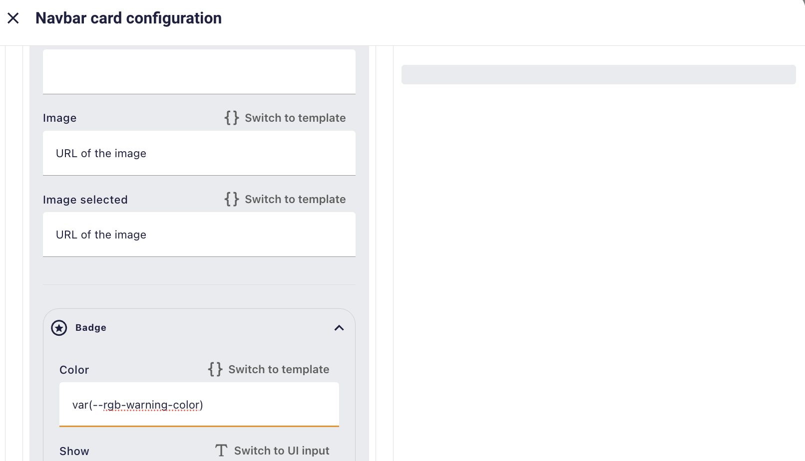

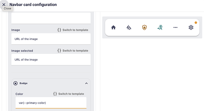

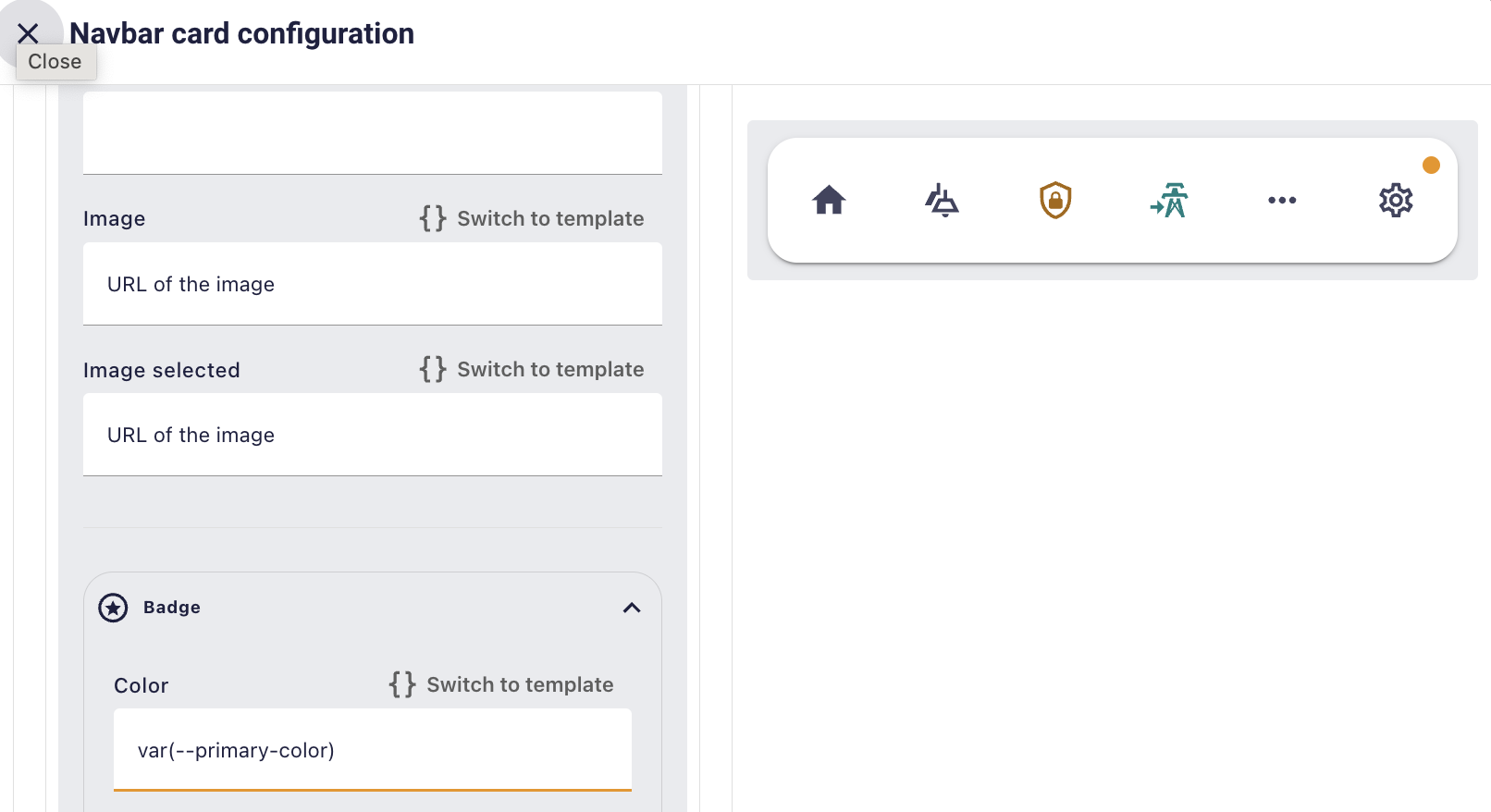

I’ve just tested with the standard Home Assistant theme in your link and it doesn’t always work.
None of the variables in my custom theme work and only some of the standard variables work.
var(–primary-color) works:
var(–rgb-warning-color) does’t work:
Thank you so much for your reply.
I didn’t explain myself very well.
I simply want the yellow circle to be displayed only when any light is on in this room.
It would be visually appealing if the icon were color-coded, of course. But the circle alone would be perfectly sufficient.
A counter isn’t necessary in the submenu (popup) since it’s already present in the main menu.
I’ve inserted your code, but the circle is still permanently displayed.
Super! tested it and works perfectly.
