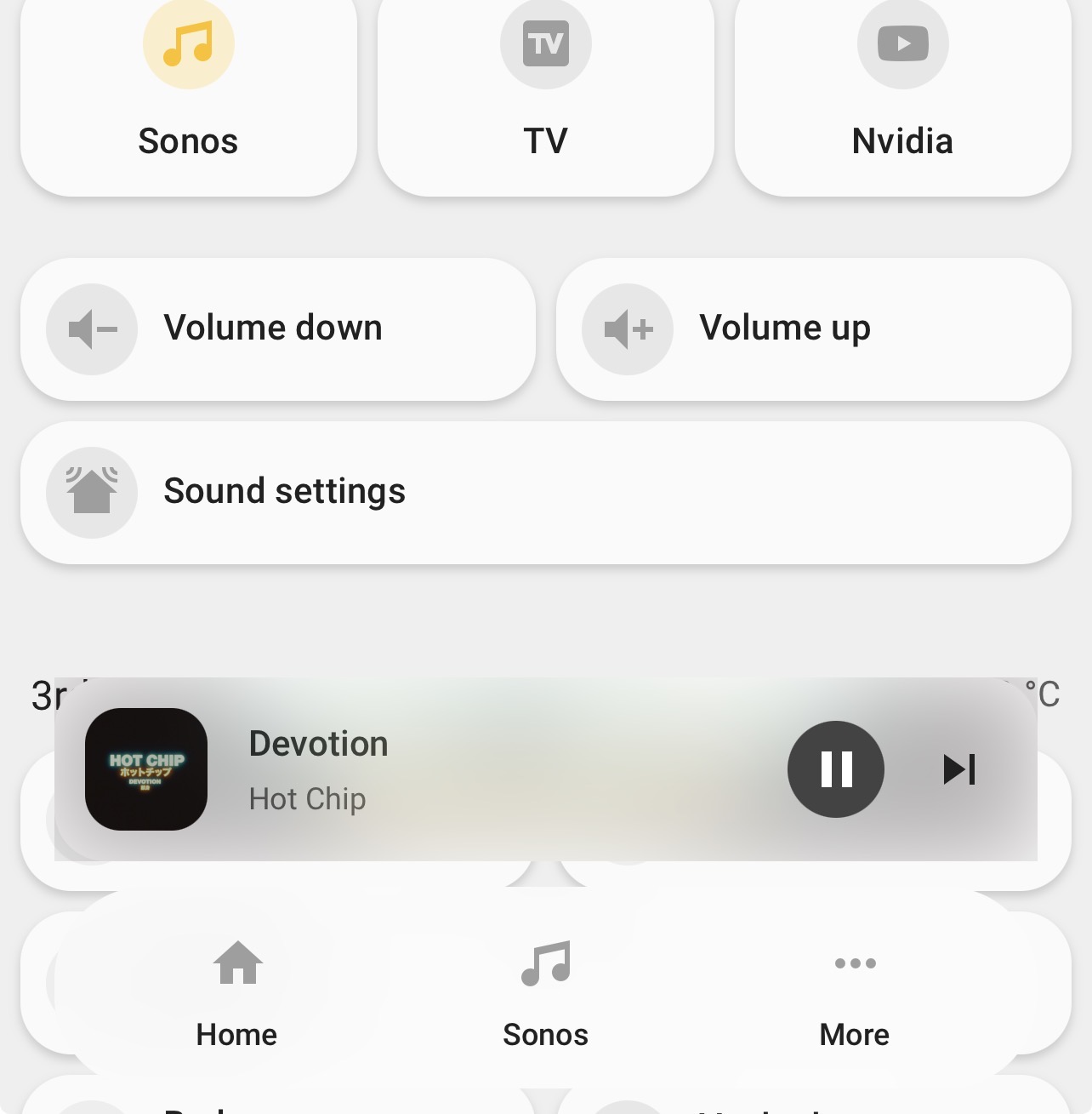

Just started to use the mediaplayer option, love it!
When turning on album cover as background the edges gets square:ish on my mobile (iOS), but looks nice and round on desktop. With album cover turned off it is fine on both.
Anything on my side or is this a small cosmetic bug?

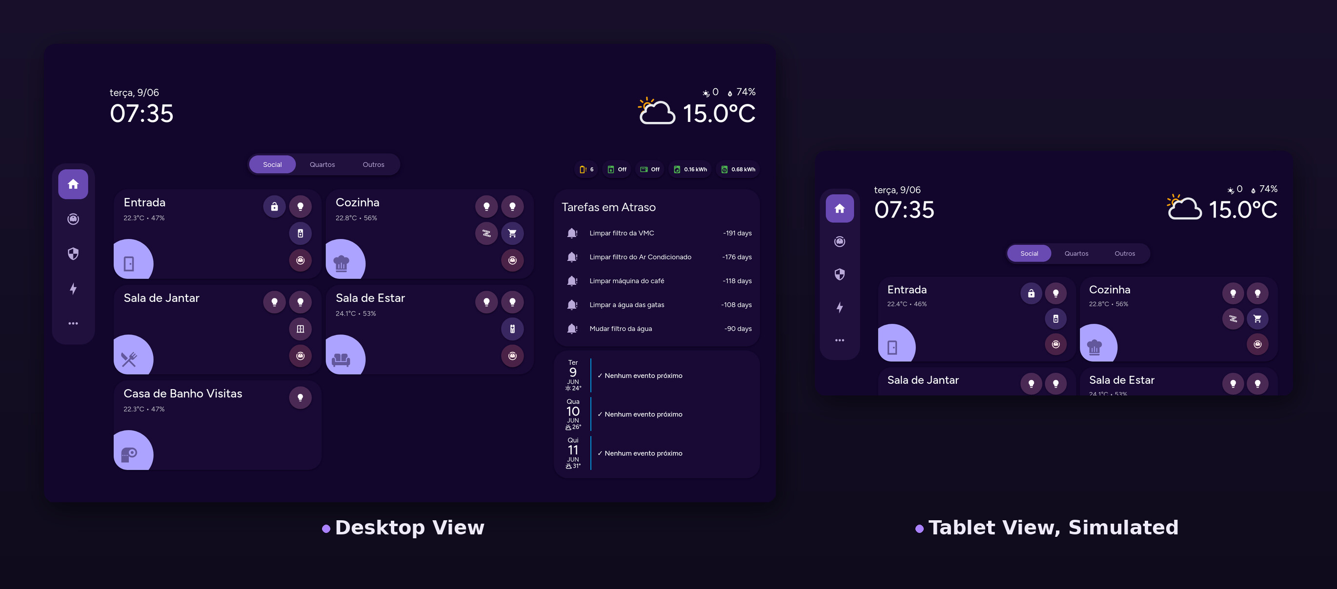

Hey everyone!
First and foremost I would like to thanks Jose Luis for his amazing work with this card. It's a pillar of my dashboard.
With that said, I was trying to see if anyone could help me sort something out. I was using the bottom bar for my wall tablet but it was overlaping some elements, so I decided to move it to the left. Everything looked great on my PC, but then when I checked my slightly more squarish wall-tablet, one of the sections was pushed back. Anyone has an idea on how to fix this? TIA!

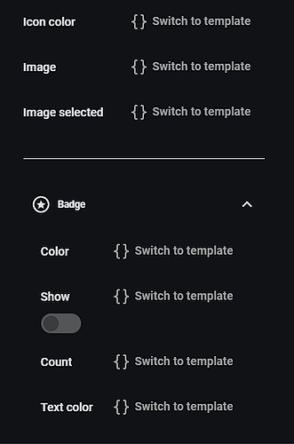

For some reason alot of the text boxes are not options to be typed in and all the toggle switches are grayed oujt and i can not toggle them on? Any Suggestions
Yep same for me, have to do those options via YAML instead then it works.
Indeed.... The advanced UI options/templating is broken.
I also get console errors about the map-thing, which gives a 404.

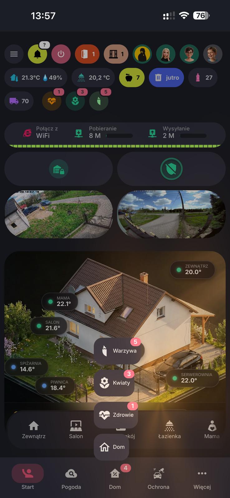

Just want to share a hack to get badge icons instead for numbers.
Me myself and claude did this so be kind. Anyone who actually know javascript and css is more then welcome to correct it, but it works.
I added this as a resource in dahsboard. /local/navbar-badge-icons.js and the file in the www folder

And then this in the navbar card under routes->badge->count (I think you should be able to put it in “css styles” but i had issues with that.)
return window.setNavbarBadgeIcon(
    3,
    hass.states['sensor.garage_door_state']?.state === 'closed'
      ? 'mdi:garage'
      : 'mdi:garage-open'
The number is the position of the route, in this case the 4th position.(0,1,2,3) and the second part is the icon you want.
