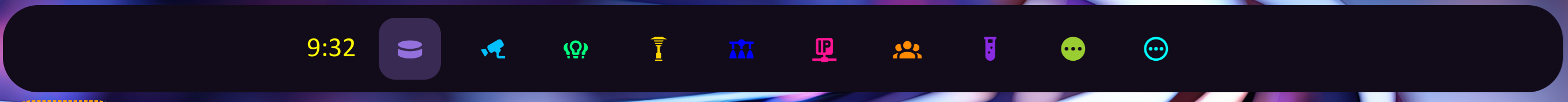

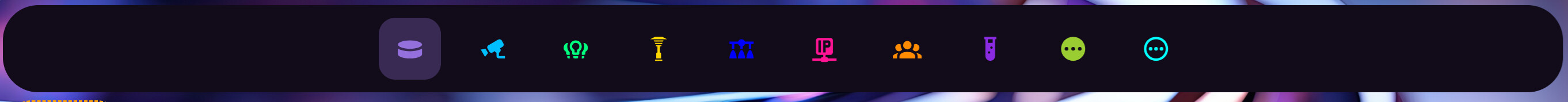

Here is what the navbar looks like, I’d love a little clock before the hockey puck:
Hoping I can get it like this:
