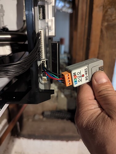

I am having issues getting data to HA and am hoping for some help.
I have an M5 atom lite/rs-rs485 connected to a Navien NPE-180S2
using this Yaml

and changing the pins to:
uart:
tx_pin: 19 #was 6
rx_pin: 22 #was 5
I was able to add the entity into HA, but it doesn’t seem to work.
No errors in the serial console of Esphome… so not sure where to go from here. Any help would be greatly appreciated.
