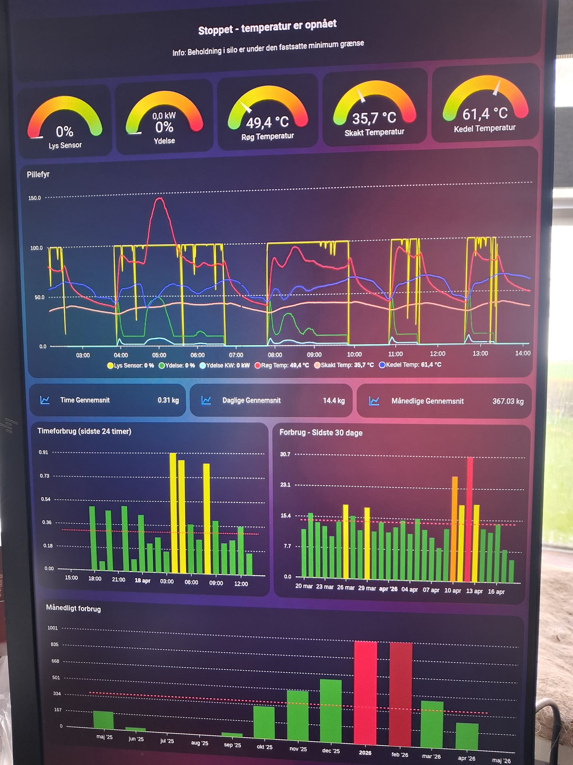

I have developed a Home Assistant custom integration for NBE pellet boilers that communicates 100% locally via UDP protocol — no cloud dependency required.
Features:
  • 300+ dynamically discovered entities based on your controller version
  • Full read access to operating data, temperatures, consumption history and settings
  • Write service to change boiler settings directly from Home Assistant
  • Button controls: Start/Stop boiler and Reset alarm
  • Backup & Restore: Save and restore all boiler settings to a JSON file
  • Multilingual support (English and Danish — contributions welcome)
  • Automatic boiler discovery via serial number
Supported controllers: V7, V10, V13 (V16 support is hoped for in the future)
