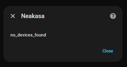

Now, when I log into the Neakasa M1 integration in HA using the second account I setup (secondary email address) HA says that the device cannot be found (see attached image)
I’m sure I must have done something wrong somewhere in this process.
Can anybody offer any suggestions??
Thanks in advance for any advice.

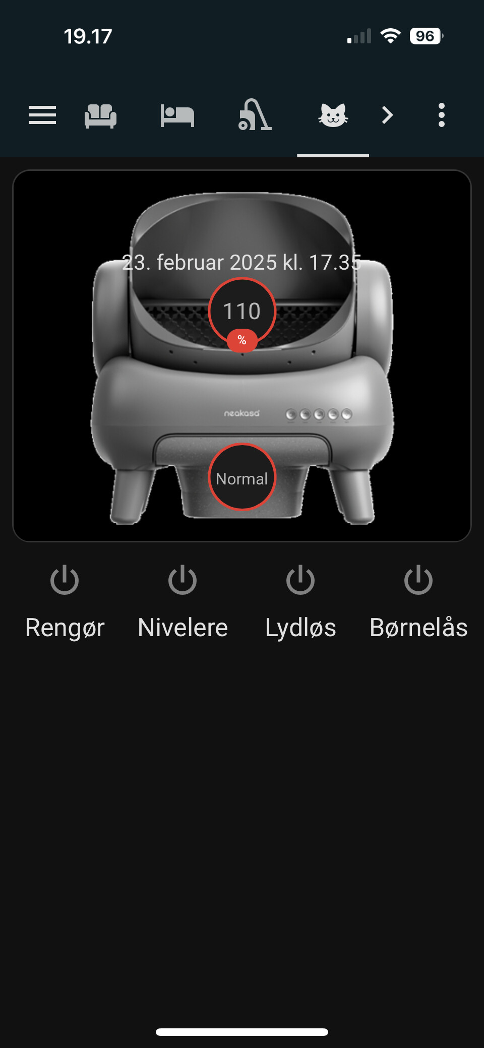

Dashboard looks great, would you mind sharing yaml?
Hey mate, do you mind sharing yaml for your Neakasa Dashboard?

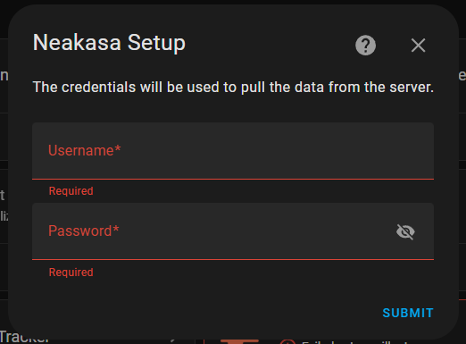

Sorry, if this is very basic. I can’t seem to get through this step. Each attempt ends in failure to authenticate. Both my wife and I signed up via google. In the account menu, we both added passwords. Every time we try to connect the integration I get an authentication error.
I’m not sure what our regions are. We both are US people living in Japan. I can’t remember what the setup was like.
Our kitty has a bladder stone and I realized the app data doesn’t go back very far, so we’re trying to store and analyze it in HA. If I could get some help, that would be amazing.
Thanks! :pray:

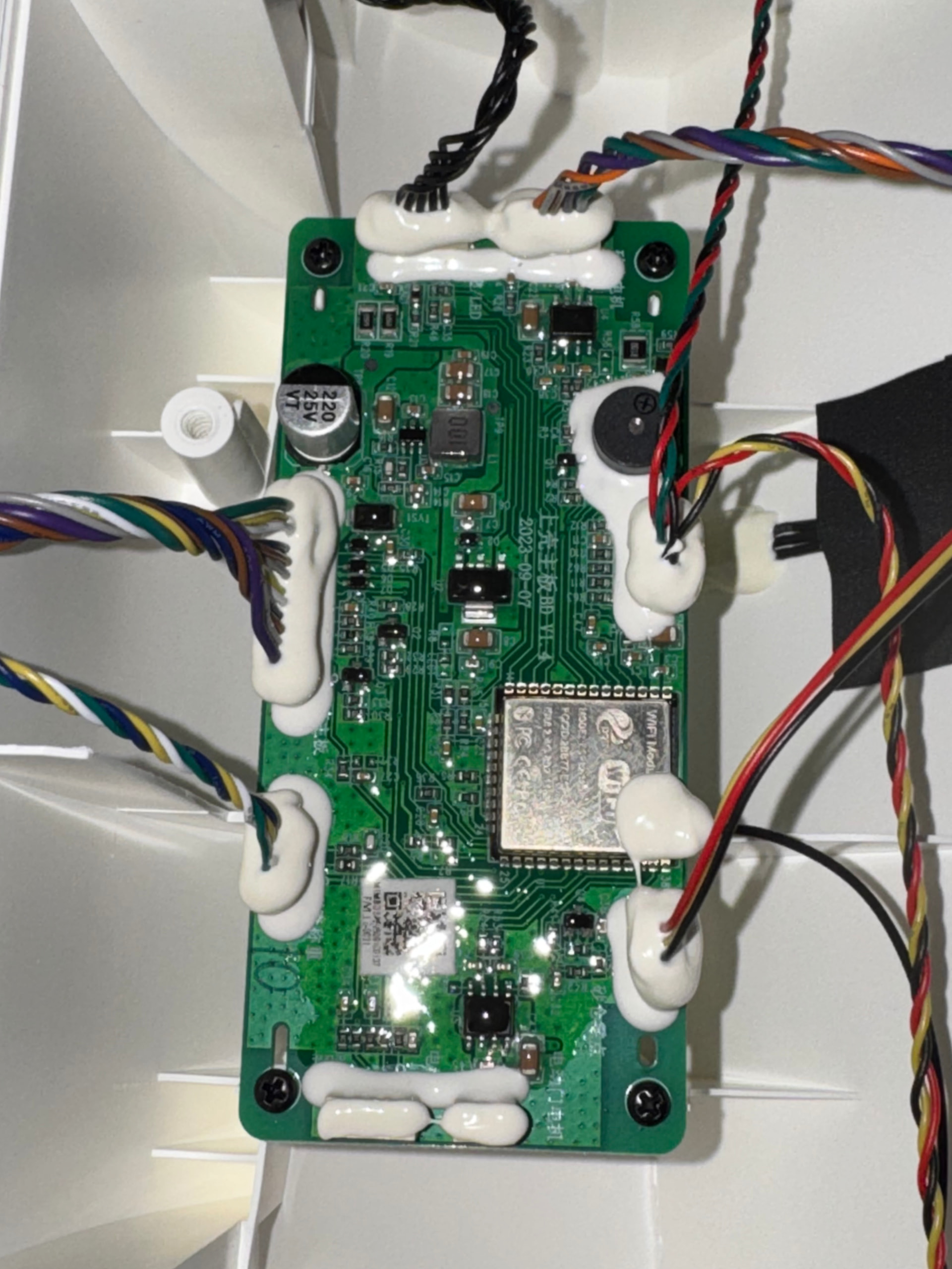

For the curious a picture of the main board
I'm glad to see the board and electronic are coated against moisture. ( as I had to hose the base as well, I'll spare you the details of what my poor cat did but it was smelly ! )
But there was no water inside at all ( I avoided spraying the buttons of course )
As expected ESP32
Specifically an ESP32-WROOM-32N
And a daughter board for the weight sensor / IR sensor
Interestingly there is a micro usb port next to the barrel jack. But no idea if it's wired for communication or just 5v power, I didn't test further.
But this is beyond my knowledge to reprogram the thing as is, but with lots of motivation, internals could be swapped with another esp32 and run esphome. There is so much space in there.

If anyone is having issues logging in (whether it be with the primary or a secondary account), make sure that account is logged out at all other places. Each account is only able to be logged into one place, and it appears this integration is not able to log out of active sessions on other devices.
